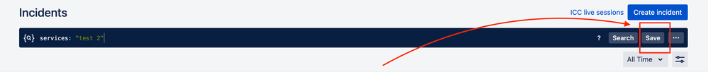

To create separate lists for each program you have defined a service for, you can use the search functionality in your Incidents menu:
Once you have defined that search for a particular Service you may go ahead and save that search for easy access and switching from the saved queries on the left side of the page:
This would then allow you to toggle back and forth between different Incident lists for each Service.

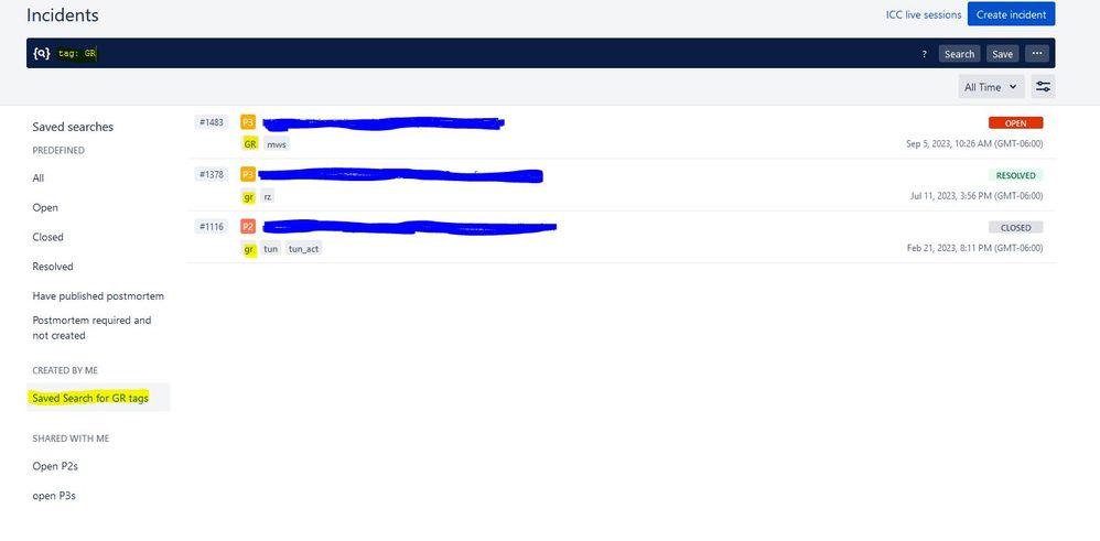

Hey @Zeeshan
Thank you for the answers. I am a bit confused though. I just created a search based off a known tag and was able to save it just now. This is not ideal, but appears to be working as I would hope it would.
Hey @Doug Garcia ,
Those are the tags added on Incidents. Earlier we were discussing searching the Incident lists via the tags added on Services, which is not possible.
