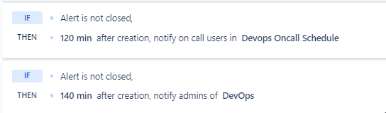

We have SLA metrics we need to track for both Acknowledgement and Closing of OpsGenie alerts.  We are good at acknowledging the issue, but are lacking in closing in a timely manner.  We have an auto close rule that closes after 72 hours, but this really doesn't help.  In some instances, a resolution can by 5 minutes.  Sometimes it can take an hour or so to resolve the issue.  I'm looking for a possibility to send a reminder to the current assignee of an OpsGenie alert to close the issue.  This could be set up 1 hour after the acknowledge for example.
Is this possible?

You can add an rule in the same escalation rule, to alert again if the alert is not closed after some time
But there is no way to notify the owner of the alert in the options.
In this case, I suggest you to notify the team leader if not closed, or the team - if the main problem is closing the alert anyone can do it if fixed, right?

Yes, we are going to give the team a couple of more weeks to improve on closing.  If we need to, we will create a manager rotation and alert them if not closed within X minutes.  Thanks.
