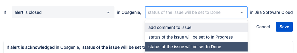

How can we setup the jira integration, to properly reflect the JIRA ticket states if there's custom states in the JIRA ticket type that link to the alerts?
The current option is very limited in customization:
I see only a way to do something like this but it would require additional effort to setup: an action to update the ticket on JIRA using a REST endpoint that would actually manage that through the API. Is there any way to avoid that?

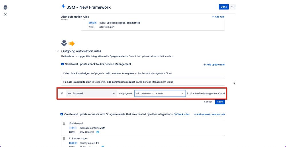

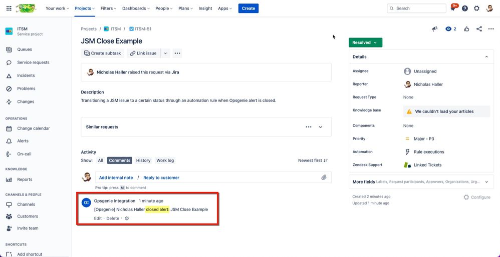

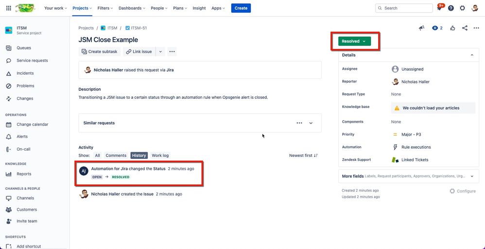

Or - instead of using OEC, you could configure an automation rule on the JSM side to transition the issue to a certain status when the alert is closed. What typically works well is setting the action mapping on the Opsgenie side to add a comment to the issue when an alert is closed:

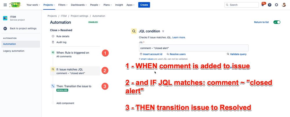

Then add an automation rule that filters on the comment, and transitions the alert to a specific status. That rule might look something like this:
JQL:
comment ~ "closed alert"
Test:
