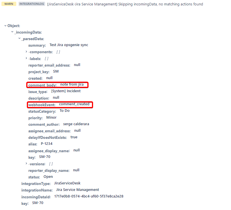

Deal all,

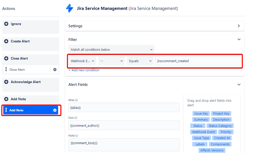

We need to add a note in Alert when a new comment is added in our Service managment ticket created by the Alert.
When we acknowledge the alert, the Jira issue comment field is updated correctly
but when we add from jira a new comment, the comment is not going back to the Alert note and the log says that No action found
The integration for Add note is fully there as seen below :
Here is the log data
As you can see from log the comment field is set and web hook event is correct
What is wrong in this which prevent this action to execute ?
regards
Nick Haller
June 29, 2021
Hi @serge calderara ,
That Webhook Event value is not correct. As your log shows, the value needed is:
Webhook Event Equals comment_created
NOT jira:comment_created
-Nick
serge calderara
June 30, 2021
Hello @Nick Haller , so stupid I am, thanks it works now.

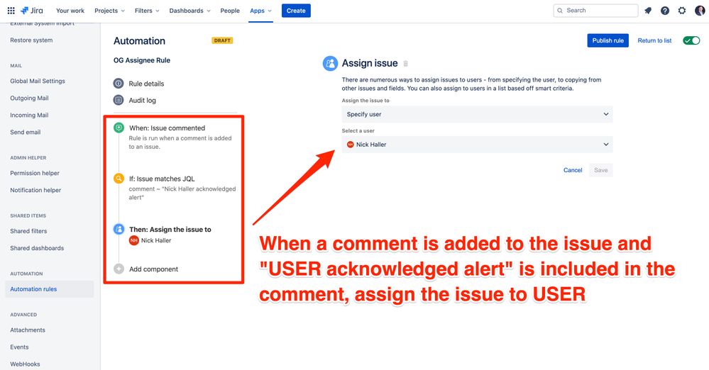

Out-of-the-box - there isn't a way to assign the JSM issue to the user that ack's the Opsgenie alert. I believe we have a feature request for this that I can add you to.
In the meantime, we have seen some customers using Automation Rules in JSM to build this functionality. I'll map the steps below:

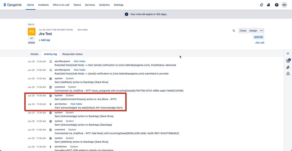

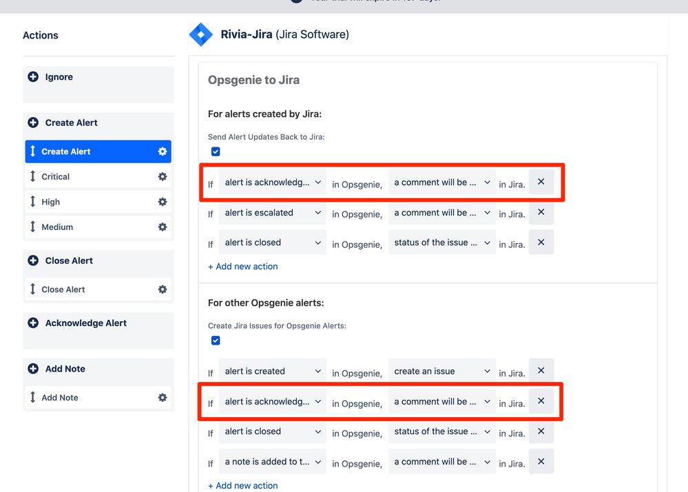

In Opsgenie - Map the integration to add a comment on the ticket when the alert is acknowledged:
^ this will consistently add a comment on the JSM issues with something like:
"User XYZ acknowledged alert:"

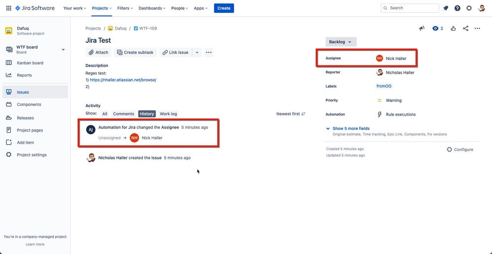

Then in Jira - create an Automation Rule that filters on this comment, and assigns the corresponding user to the issue:
Here's an example of that in action:
One thing to be aware of is you'd need an automation rule for each user, so it's not exactly scalable on a larger level, but it is realistically the only workaround at this time.

June 30, 2021

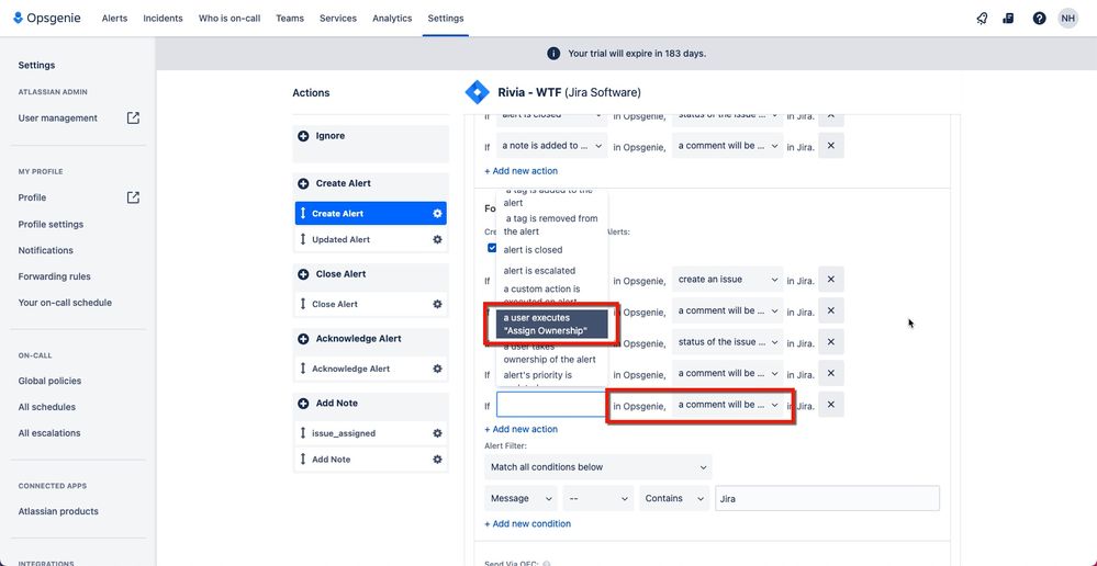

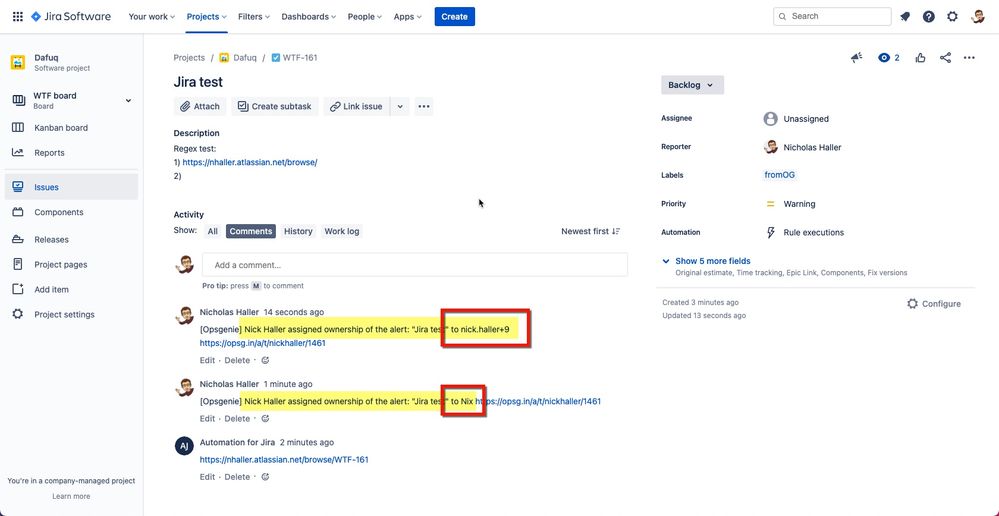

You can map a number of different Opsgenie alert actions to add comments on the JSM issues - like if the alert is assigned to another user, Ownership is taken, etc.:
Then use the steps outlined above with automation rules - filtering on the comment - and having the automation rule complete an action - like assign it to a user:
The comment will vary depending on the action. If I wanted to filter on the comment above when assignment is taken, I'd probably want to used "to User XYZ."
Again - we don't have anything out of the box so using automation rules for this use case is the closest workaround.
I'd suggest you do some testing on your end - adjusting what Opsgenie alert actions are taken, how they post as comments, how you want your automation rules to act, etc.
