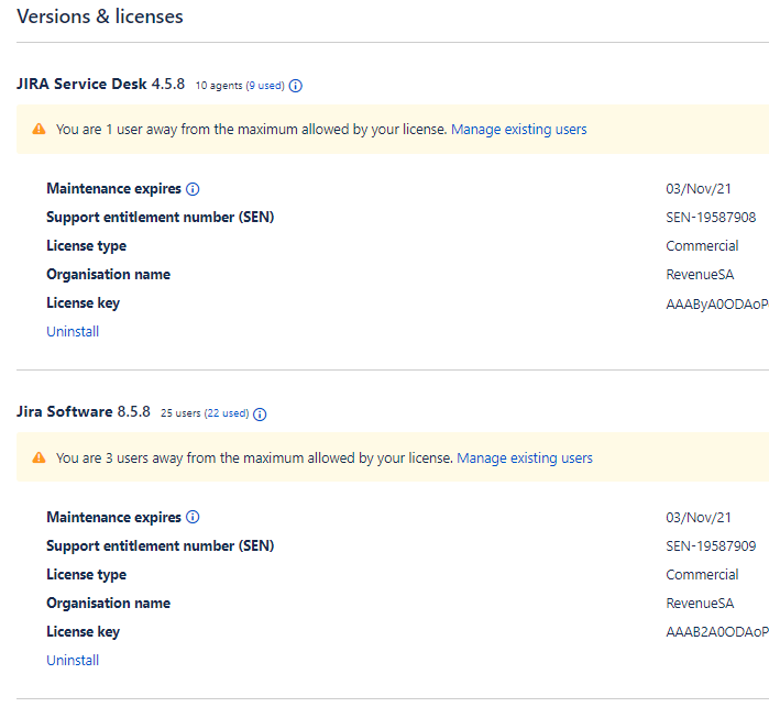

We have the JIRA server and not the cloud version. All I know that we have 10 JIRA Service Desk 4.58 license(almost exhausted as have used up 9) and 25 Jira Software 8.5.8(22 used up - screenshot attached - 1.PNG). I am not sure what is the scope of this two features and if it included JIRA Core and its scope also!

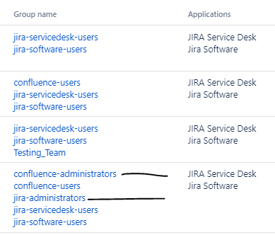

We also have JIRA confluence, do the JIRA confluence eat up any of the above licenses or does it require separate explicit license? What license is required for Confluence administrator and Jira administrator?(Screenshot attached - 2.PNG)

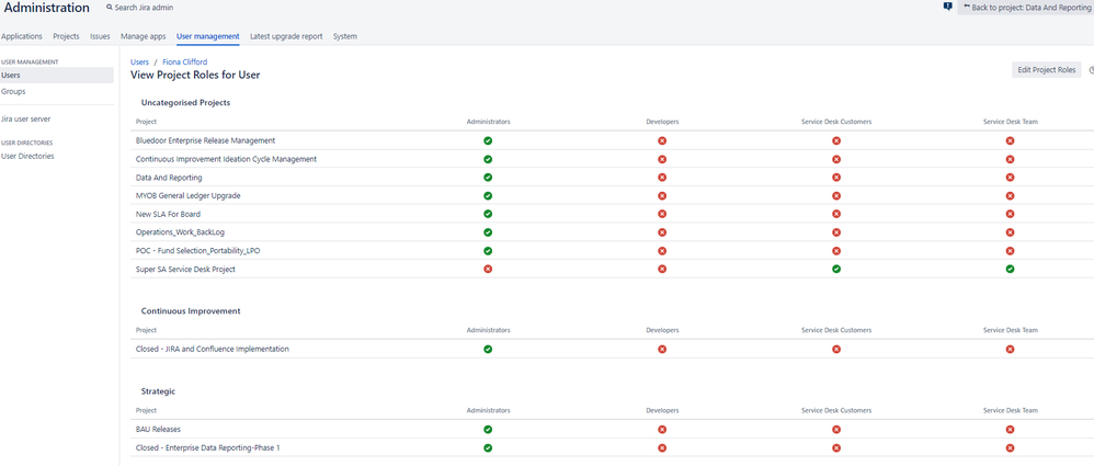

Did you mean to say that someone to be able to create a project and manage it, they need to be JIRA administrator also? Is there any way of granting project creation access to a user via Project roles and not by giving admin access(Screenshot attached - 3.PNG)?
Your second screenshot is the one that shows us the most important stuff (if you were on Cloud, your third one would also have shown us some of it, but server is a bit less helpful there)
So a quick breakdown:
You have no Core users set up, so I'll stop talking about that. (Your Software and Service Desk users are using core, but as part of their Software and Service Desk licence, so we don't need to worry about it)
The Service Desk users are allowed to be Agents - they can use all the functions in Service Desk projects.
The Software users can use all the Scrum and Kanban functions in Software projects.
Your Software-only users can not use Service Desk projects in full, they only have limited access, they can see, comment, be named in, and do some other stuff in these projects, but they can not transition issues, configure the portals, be assigned to issues, log work on them and so-on. Equally, Service Desk Agent-only people can not use the boards and scrum/kanban features in Software projects.
So, take a look at your second screenshot with that in mind. It tells you what groups are named for getting access to the various applications. To find out who is consuming licences, look at each named group, get the list of people in it, and add them all together (deduplicate though - if someone is in three different groups that grant Service Desk for example, they still only take up one licence)
Your administrator groups are handled elsewhere. Look in "global permissions" to see what groups are granted admin. Again, you'll want to look through those lists and de-duplicate.
