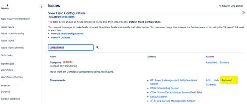

Someone has unfortunately made the field required and field configuration screen scheme that your project is using does not expose the field for the create screen. The question is should the Field be added or should be required option be removed altogether? Generally speaking components is it a required field.
Can you first verify if the field configuration is set to required? The image below illustrates where this is set under admin/issues/field configuration and select your config. if it shows "Optional" where I highlighted "Required" then someone set it to required.

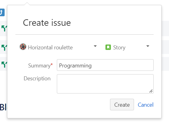

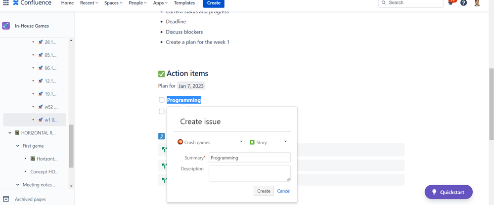

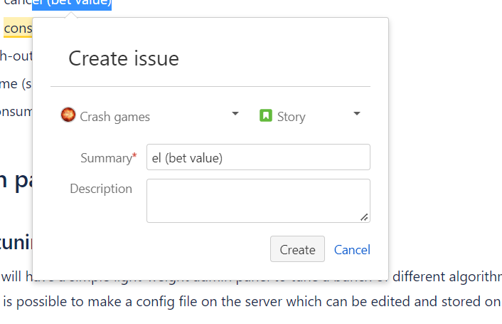

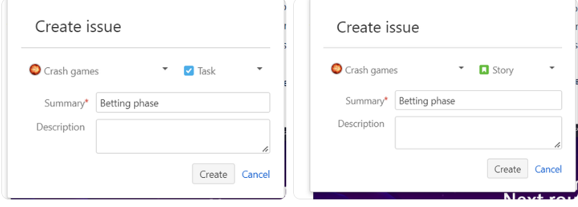

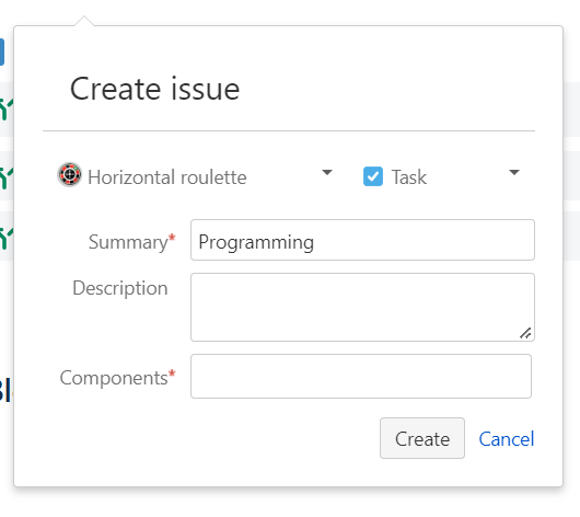

Sure. All issues in all cases I am trying to create in Confluence - right click on highlighted text and create issue. The problem that sone users see Components field in that case - some no.
If give more details - some issue types in some projects (Epic, Bug, Task) have this field, but some Story in that case - no. (please see screenshots)image.pngimage.png
