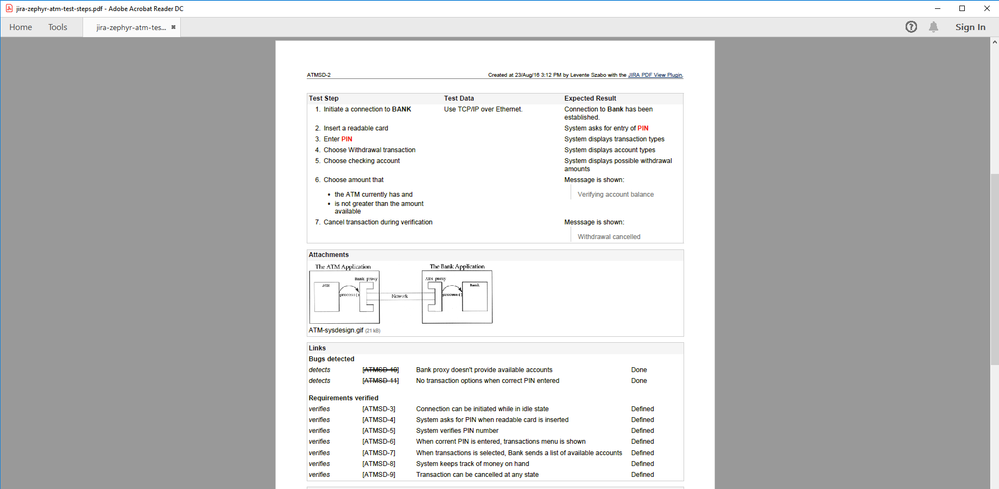

In the meanwhile it has also been released for Jira Cloud! See the Zephyr test case to PDF export guide.
jira-zephyr-test-steps

We are currently working to integrate the Cloud version of Better PDF Exporter with Zephyr, so you can export Zephyr Test Steps (and other Zephyr managed custom fields) to PDF.
