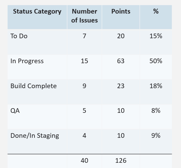

Hi,
I'm looking for a solution that show the progress of the tickets through the sprint. The burndown chart is binary and gives you "credit" when the ticket enters a resolved status or the right most column on the sprint board.
However, I'm looking for a way to report the progress of the tickets through the various columns. I don't know of a way to do this in Jira and I understand columns set up is merely just a UI thing (save for the 3 statuses you get with To Do, In Progress and Done).
Am I missing something or is there a marketplace app I can bolt onto Jira that can help?
Here is an example screenshot of what I showed my team just today, but it required exporting and data manipulation.
Thanks!
Eric

Eric Lynch
January 30, 2025
Thanks @Daryl Marsh
I see your point here on issue count but where is the aggregation of the story points happening? That still seems like a manual exercise.
Also, the status categories I have in my screen shot are not necessarily the columns I have on my board. I have simply broken down the build SDLC into these categories to help illustrate how things are progressing in the sprint. In actuality we have way more columns on our active sprint board.
