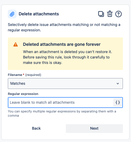

You can use the Delete Attachment action to delete Attachments based on using regex to match the attachment name.

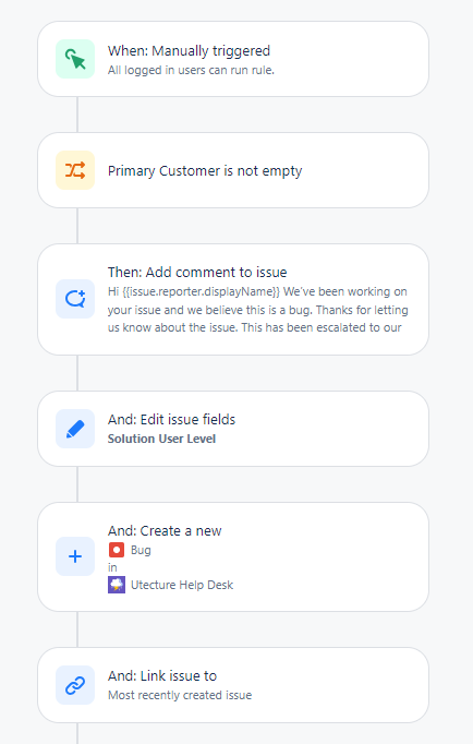

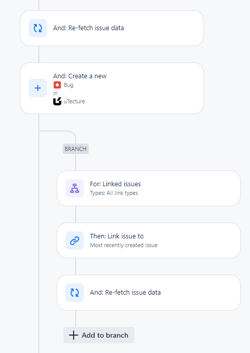

Thanks for taking a look. Here's the automation.
Screenshot 2024-12-05 115549.pngScreenshot 2024-12-05 115639.pngScreenshot 2024-12-05 115740.png
Image 3 is the copy field setting. The Bug Description field is multiline custom field with pre-filled format and uses Wiki style render to bring through formatting. Works fine except no images or attachments copy correctly.

Currently I'm not seeing a method to accomplish what you want other than initially copying all attachments and then using the Delete Attachments action to remove the ones you don't want.
There does not appear to be an API endpoint that you can call to copy specific attachments from one issue to another.
There might be a way to use the API to get specific attachments from one issue and then add them to another, but the API to add an attachment to an issue appears to be based on uploading an attachment from location.
