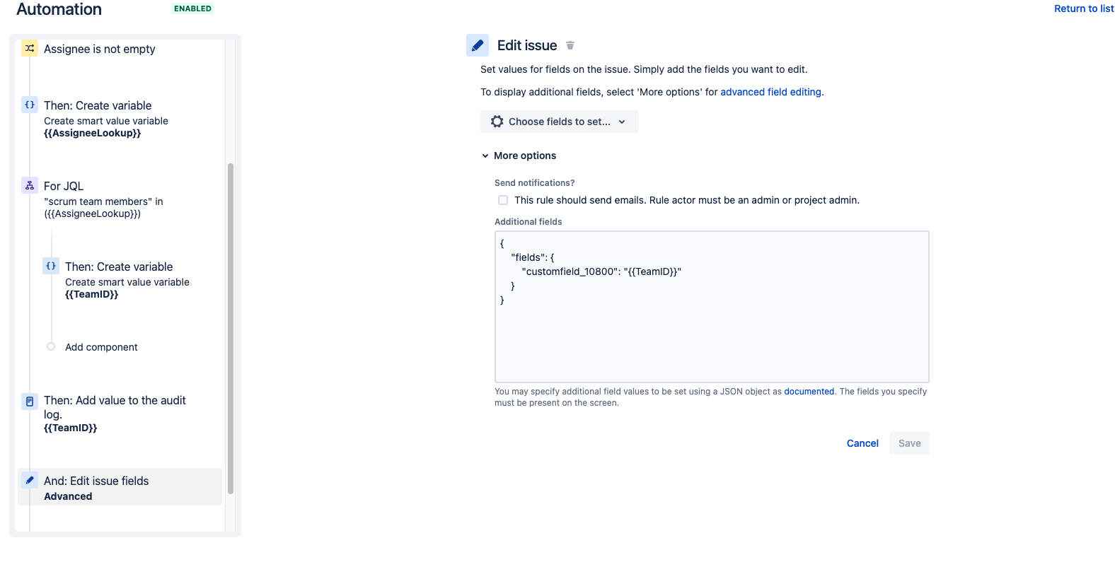

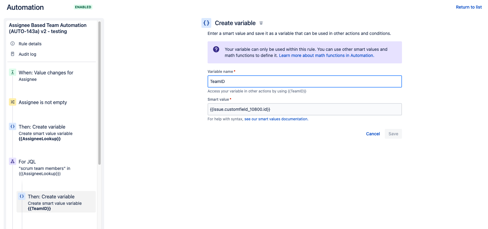

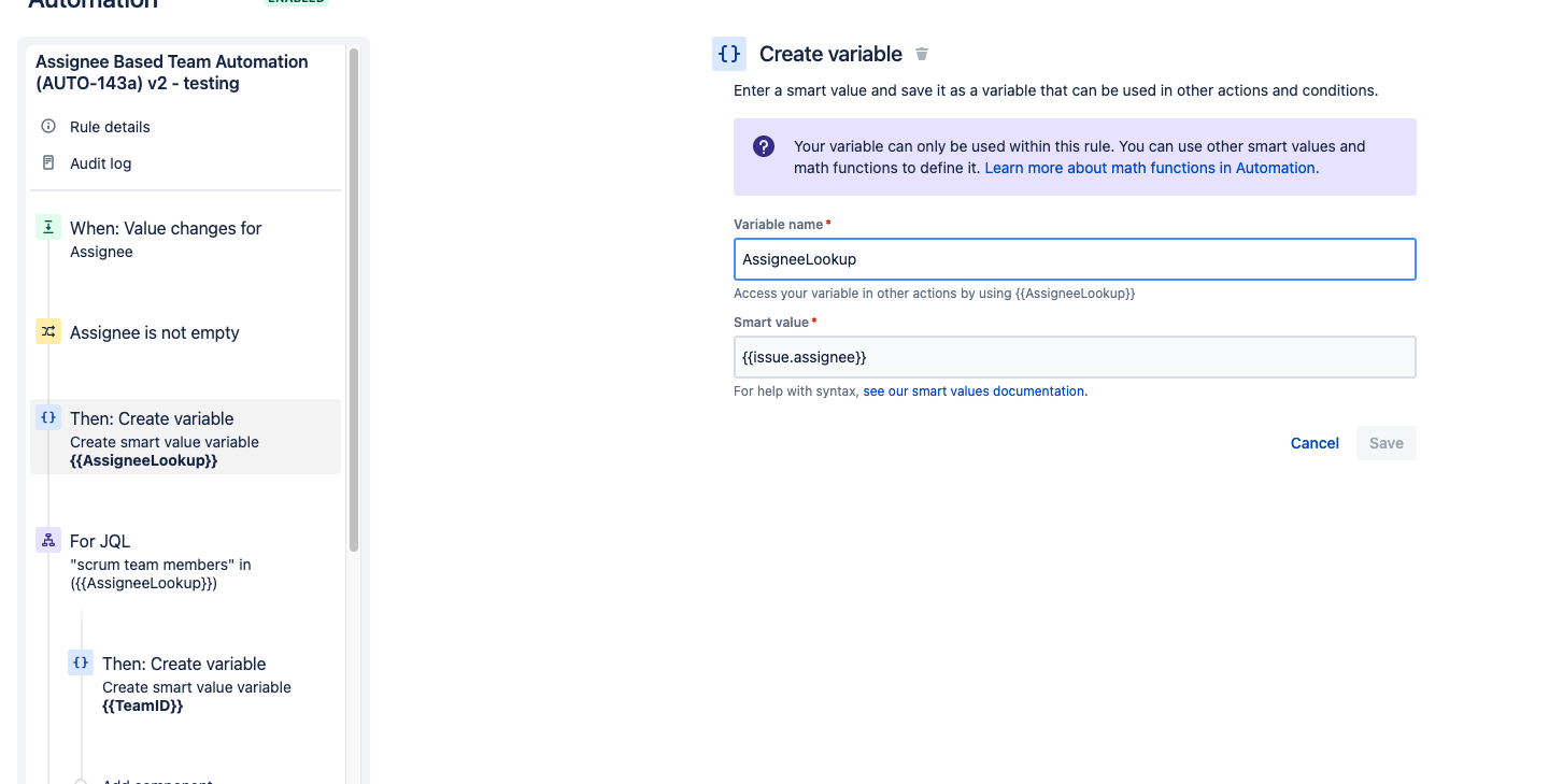

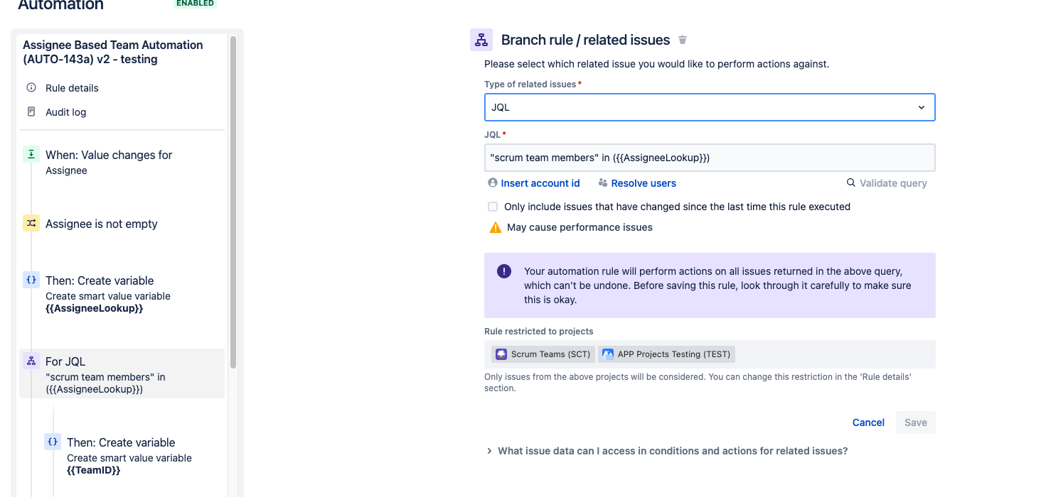

I am trying to create a variable inside of a branched JQL lookup and then use that variable outside of the branch.

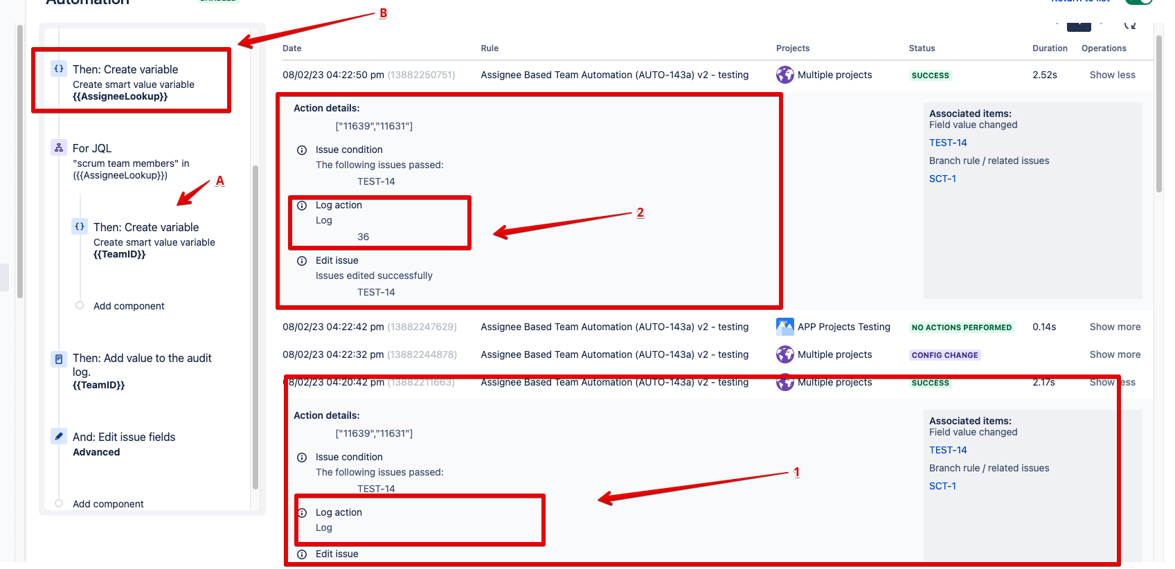

Referring to my below screen shots, I was trying to access Variable A in the "Advanced Edit" at the bottom of the automation rule (which was located outside of the branched rule.
You can see in box #1, logging the action produced no result.
However, when I added Variable B (at the top) before the branched rule, it then changed something which then allowed me to access variable A outside of the automation rule (refer to box 2) which shows the log action.
Below are screen shots of the entire automation rule if anyone wants to see what I am doing. The custom field 10800 is the Teams field that comes from Advanced Roadmaps, and has limited functionality inside of the automation tool, so I must manually manipulate it.
