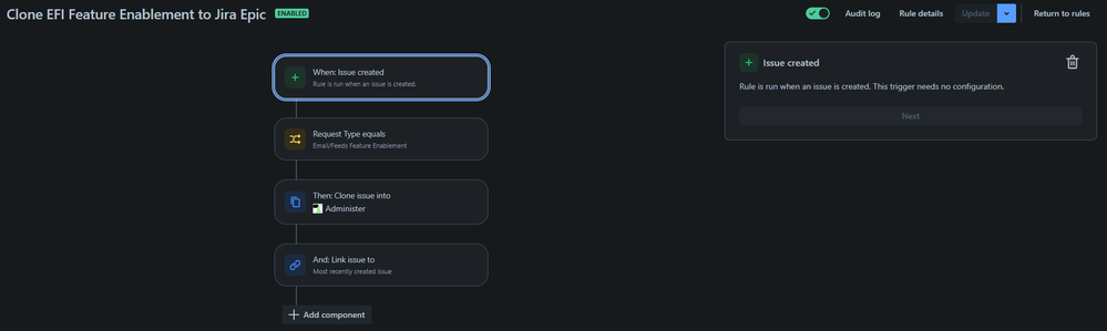

A team member reached out to me to advise that a previously working automation was getting triggered twice. I've looked over the automation and I'm not seeing any reason why it would kick off two times.
Automation in question:
Here's a snippet from the audit logs showing that there were no config changes between the last successful run (single run) vs the most recent run (duplicated):
I've reviewed all audit logs for the offending issue key and there was only a single automation that kicked off against it (expected). So I'm not sure if this is something that I need to make adjustments on the automation or something else.
ADMIN-9266 is auto-generated from a user submitted ticket from a different project.
Here's the rule that generates this ticket:
I did confirm that "Check to allow other rule actions to trigger this rule." is not enabled.

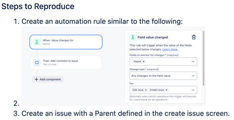

I wanted to follow up as I did receive a response from Atlassian Support. They've advised that this issue is being caused by a bug that monitors the "Parent" field.
Here's the bug ticket: https://jira.atlassian.com/browse/AUTO-1616
I did confirm that while the ticket current only specifies the "Field value changed" trigger it does seem to be affecting other triggers than the one identified in the ticket.

That response from the support team is very troubling, and they should change the defect Summary and raise the Severity of impact.  Many rule writers likely assume the defect only happens for the Multiple Issue Event trigger or the Field Value Changed trigger with both create and update changes selected.
My hypothesis of why this is happening for those triggers is related to how automation rules use the REST API after the change from Epic Link to Parent:
This does not explain why this would ever happen for the Issue Created trigger.  I will add a comment to that defect.

I appreciate the additional input. I had brought up a similar concern that while the results were the same the cause was not. This is the information they provided - although it still doesn't entirely align with the existing bug ticket:
While the bug mentions the 'Field Value Changed' trigger, we believe that the problematic behavior is due to the Parent field. As seen in the steps to reproduce below, the problem occurs when the 'create issue' operation is being called with Parent defined data:StepsToReproduce_existingBug.png
I have added an internal comment to this bug asking that we either update the Summary or spin off a new bug, linking it to this existing one.

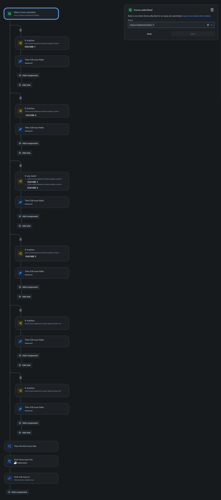

I wanted to keep this discussion updated. While support did indicate that the issue was related to the bug outlined above, it seemed off - as you noted Bill.
I rebuilt the automation that was originally kicking things off and I haven't seen any duplication of Tasks since it was rebuilt.
Original automation:
Rebuilt automation:
The new automation was built out to intake form data which the original did not need to have as it was just using the fields provided in the Request Type setup.
I don't have the "Action: Clone issue" any different than the original one; however the trigger here is different. I've tested submitting the request connected to this form and confirmed that the automation that kicks off the tasks is only getting triggered once instead of twice. So it's back to working as expected now!
