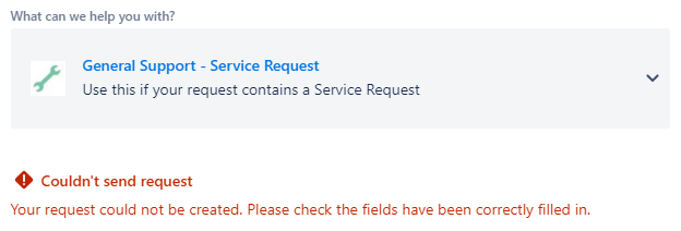

I am new to Jira and I wish that I can find help here.
I have a service desk project and when I create an issue form the portal I get "Couldn't send request"/"Incorrect request type" error message. However, the issue is actually created successfully on Jira Application and can be seen in portal if I click Requests/Created by me.
Note, I didn't use to get this error before. I successfully created so many issues from portal. This happened all of a sudden.

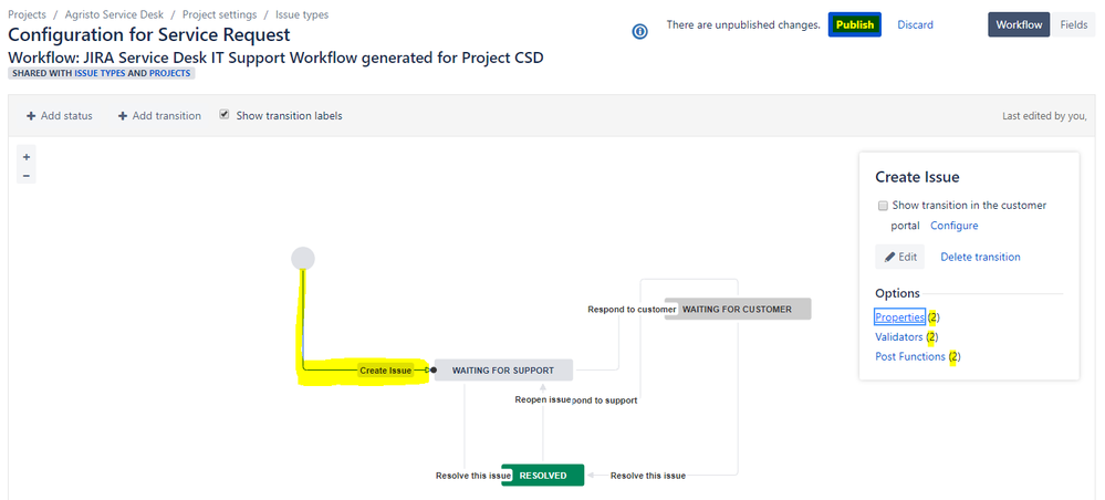

Let's take a step back as it seems to be getting a bit complex.
So what I suggested you do are as follows:
Option 1
Option 2
If I publish the draft regarding the transition 'Create' for issue type 'Service Request', would this only effect new 'Service Request tickets'?
Yes it would. Published workflows affect all issues that are created after they are published provided they use the workflow.
Similar with the entire workflow, would it only change for new 'Service Request tickets'?
It would change for all issue types that use this workflow. On first glance, it seems the issue type is only used by this project and issue type in the project however as I cannot tell, you would need to verify this on your side.
If indeed it is only used by the issue type, then it applies to only this issue type in this one project.
I hope this helps.

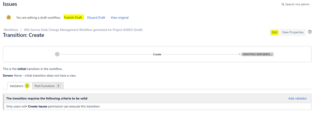

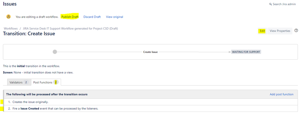

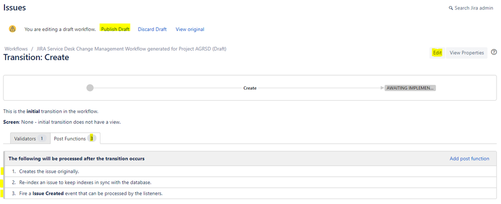

The issue type 'Service Request' is similar to 'Change Request' (CR) as they are both considered as general support. Therefore I will give you the properties/validators/post functions of the 'Change Request' to compare:
Change Request workflow with information regarding the 'Create' transition:
To solve the issue of not being able to create a Service Request by our clients, can I just adapt the properties/validators/post functions so that they are the same as with a 'Change Request'? If, after adapting them, can I just 'Publish Draft'? Would this only have effect on new tickets with issue type 'Service Request'? Also after adapting the workflow, what effect would it have on the tickets if I were to publish it?

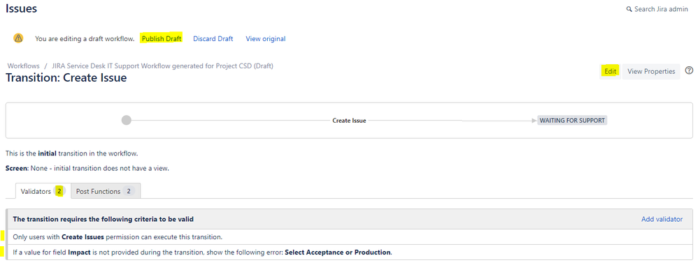

Can you remove the Validator that is checking the impact field value?
I do not see the impact field present and would like to see what happens if this validator is removed. (Please ensure this is the Workflow mapped to the issue type associated with the request types).
After removing it, do save a copy of the original and test to see if this resolves the problem or not.
Cheers.

the validators for the Service Request workflow vs validators for the Change Request workflow:
Service Request workflow with information regarding the 'Issue Create' transition:

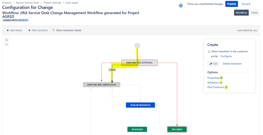

Change Request workflow: I will discuss this in the next comment in case this becomes to big :)

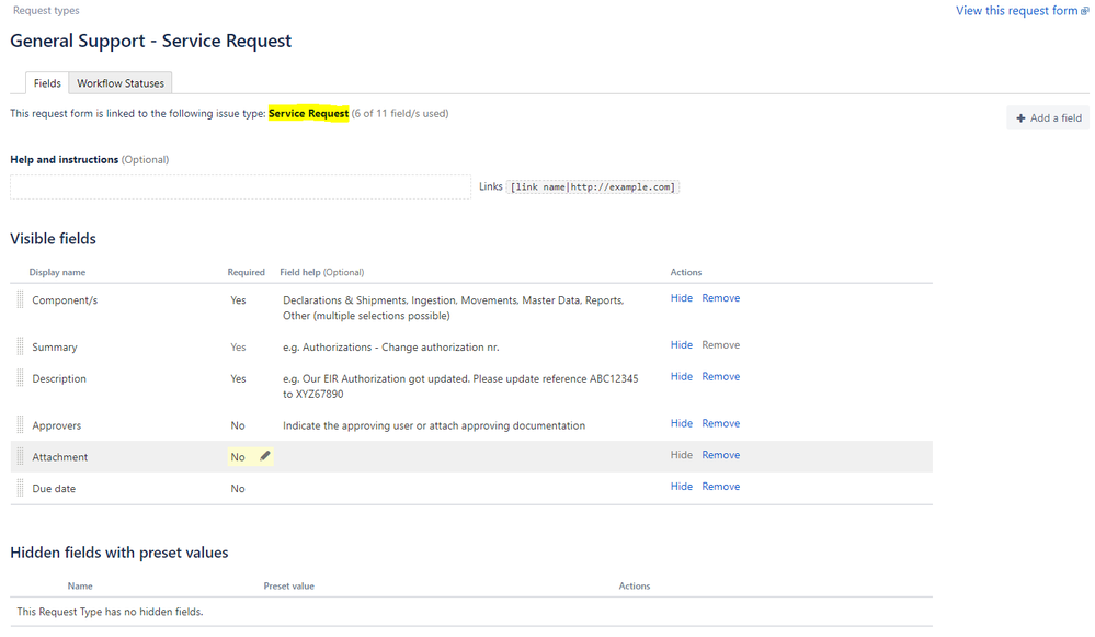

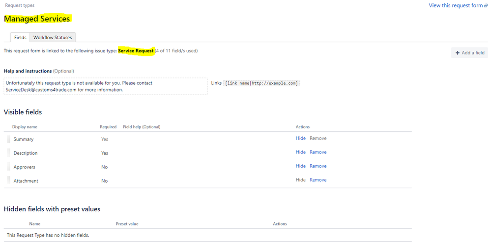

Hi @Steven Bortels ,
Sorry for the late reply. Yes I meant those screenshots.
From the first screen, I see the component, summary and description fields are required when raising the General Support request type and for the Managed Services, just the later 2 are required.
Can you confirm if these are populated each time a request is being created.
Check your workflow for validators when creating an issue and remove any that are there as this could potentially be the cause of the problem. (I mean the transition from the initial create to your first status. This is quite likely the cause if both request types share the same workflow)

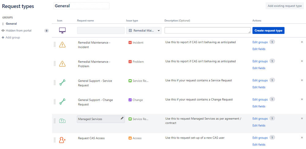

Hi Ismael,
Thank you for your feedback!
Screenshot of Request types:
Screenshot of Request type 'General Support - Service Request' with 'Service Request' as Issue type:
Screenshot of Request type 'Managed Services' with 'Service Request' as Issue type:
I hope you mean these screenshots.
Thank you for looking into this!
I receive the following error message when trying to created a 'Service Request' ticket:

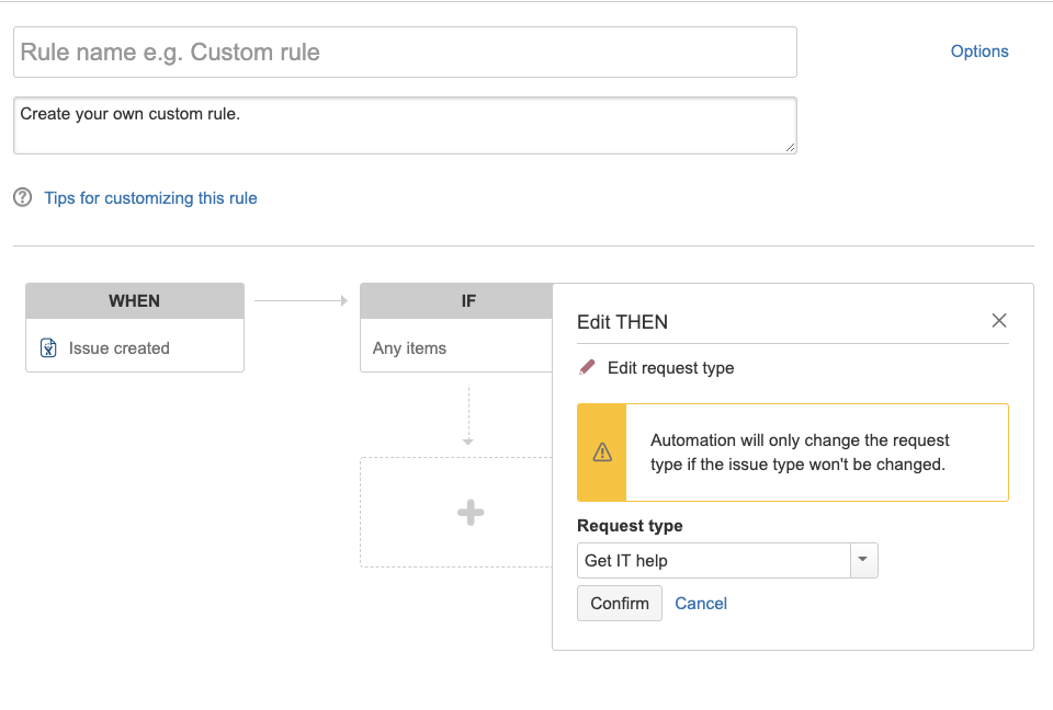

Allow me to answer scenario:
When I (Admin) create a Jira ticket for client (specific project), client can't see the content
Well for this, can you confirm if you are pressing Create in JIRA and directly creating the ticket? If yes, you have 2 options to fix the problem:
Automation:
This allows you to create issues as usual from the JIRA UI and should automatically set a customer request type which is needed for issues to appear in the customer portal.
Create issue from Portal
An alternative to the above is to create a ticket for the client from the customer portal as follows:
Either of these steps would solve the problem with customers not seeing your request when you create it for them.

When navigating to Project > Project Settings > Request types, I have the following:
Request type: Issue type:
General Support - Service Request Service Request

I did that. In fact, the request is not going to appear on portal if it’s not mapped in the project setting/request types.
Thanks
Hi @Omarz
Can you go to project settings, request types page and ensure you have an issue type mapped to your request type.
This is the most common reason you get the error you described.
Select the same request type that gave you the error.
