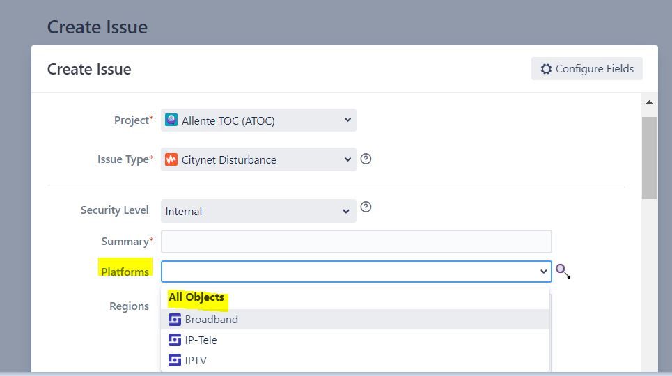

A. screenshot of project A : called Allente TOC and the field is called Platforms

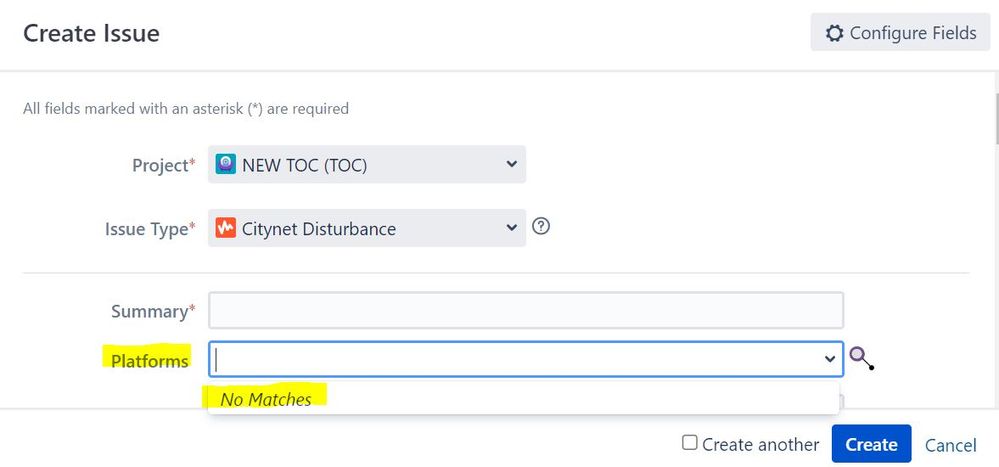

B. screenshot of project B : called NewTOC and the field is called Platforms

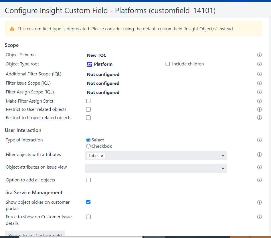

C. configuration of Insight for the field in New TOC (project B)

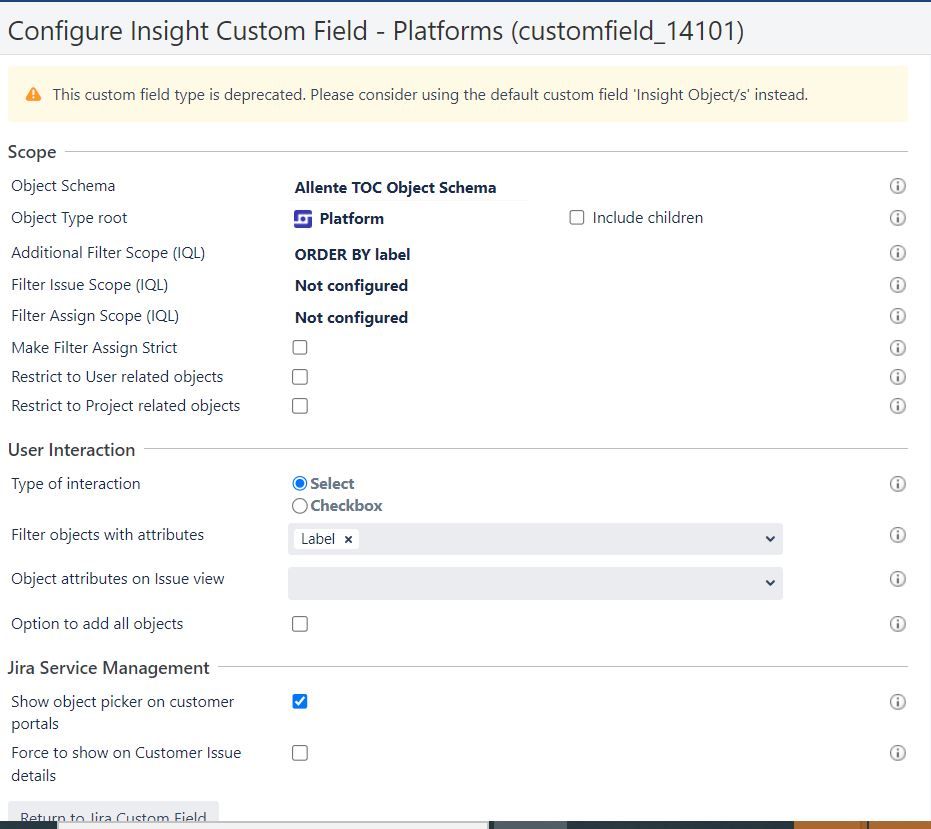

D. configuration of Insight for the field in Allente TOC (Project A)

All the configurations seem correct and I assume that you have configured the New TOC's Platform objects as well.
  1. Click Asset -> Search for object
  2. Select New TOC object schema
  3. Type the following AQL
    1. objectType = "Platform"
  4. The result should not be empty
The next step is to check if the New TOC configuration:
  1. Click on Asset -> Object Schema
  2. Click the Gear icon next to the New TOC object schema
  3. Click Configure
  4. I would suggest you compare the Object Schema configuration in New TOC with the Allente TOC Object Schema and make sure they have the same configuration
  5. Make necessary changes in the New TOC configuration and try to create an issue in project B again

here is the problem , in my "New Toc Object schema" I see all Object types bcause I copied from project A but there is no object there .
none of the objects were copied .
that means I manually need to add objects from other Insight Schema ?

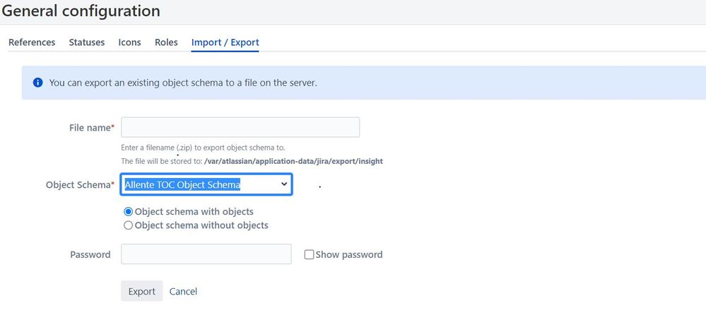

I just don't know why it didn't work for me with export and import .
in Export I did this :
but when I go to import , I can't find the name of the file I saved
NEGAR JALALIAN
March 13, 2023
@Marini Marini  finally I found how to export and import .. my expectation was too high and thought I can do all at once but I had to do export and import per object type
