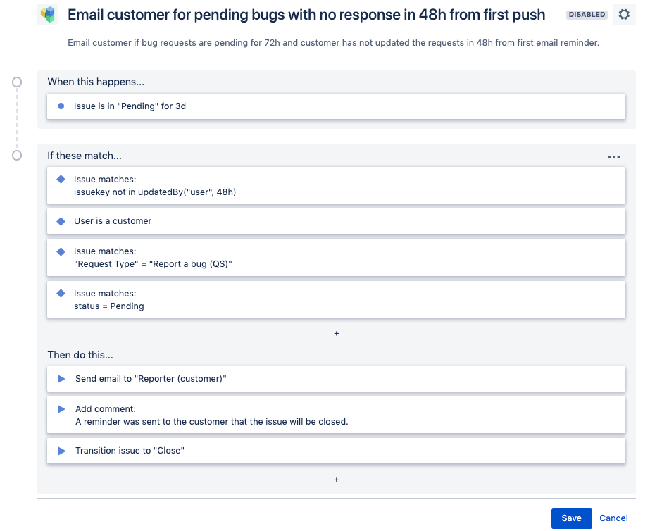

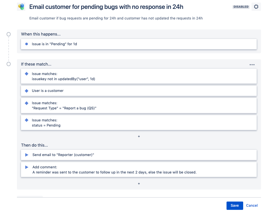

I'll insert 2 print screens of what I managed to create, but unfortunately is not functional:
Do you guys have any ideas of how I could set these rules?

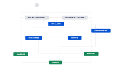

To send two reminders for the customer, I believe it will be necessary to use one more status, so let's call this status "First reminder".
This is my workflow and I added the status with the transition from Waiting for support > First reminder and the First reminder can go to Closed or Waiting for support:

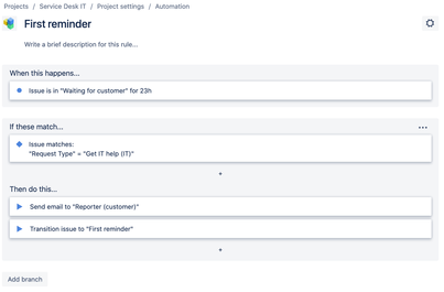

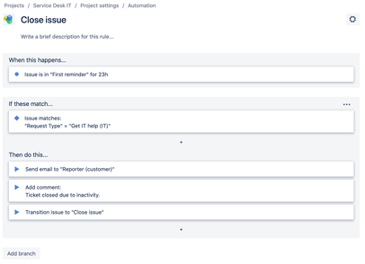

With the workflow configured, we can create the automation to send a reminder and to close the issue.

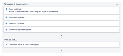

After that, we also need to update the automation for the issue to be transitioned back to "Waiting for support" in case the customer replies to the first reminder. By default, there is an automation called "Comment updates reply status" and we need to add a new branch.
