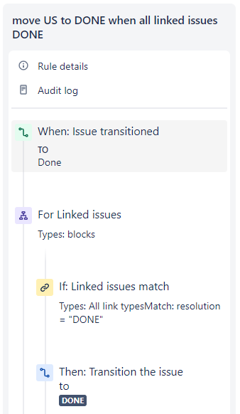

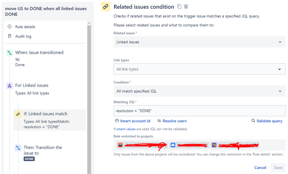

I tried to create a rule with "Multiple project" scope to move an issue to DONE when all linked issues have DONE:
And I found that this rule has the reverse effect like this:
Project A - Task 01 has bellow linked issues:
+ Project B - Task X
+ Project B - Task Y
=> As we expected, when Task X and Task Y move to DONE then Task 01 will be DONE, but if we move Task 01 to DONE it also makes Task X and Task Y move to DONE
Please help to resolve the situation.

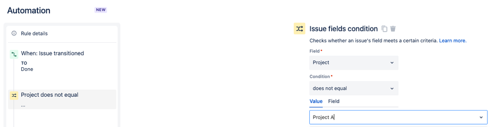

Hello @Tâm. Nguyễn Thanh
After the Trigger add a Condition to stop the rule if the issue that transitioned to done was in Project A.
Tâm. Nguyễn Thanh April 9, 2023
Thanks, Trudy so much, It worked !
