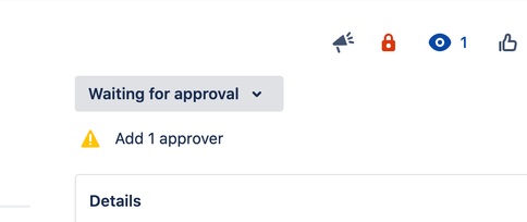

  • If your issue is indeed that issue type, or if you have your own type / workflow configuration with this logic built in, you should see "Add approver" on the top right.
    • Or if an approver has already been added, look for the "Approvers" field on the right side panel and you can click it and add the user there.

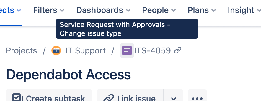

A couple of screenshot to help   :)
IssueType Service Request with Approvals icon:
top right Add Approver alert:
