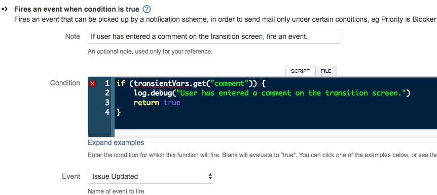

I think @Alexey Matveev essentially gave you the correct answer, but you just need to apply it as a post-function that fires a condition when true and not strictly as a validator. For example, your condition would be this:
if (transientVars.get("comment")) {
log.debug("User has entered a comment on the transition screen.")
return true
 Screen Shot 2017-11-13 at 4.00.38 PM.pngPlease note: just ignore the static type checking error, as the script will still work.
I have tested it successfully and can see it's working from the output in the logs:
[scriptrunner.jira.workflow.ScriptWorkflowFunction] User has entered a comment on the transition screen.
[jira.workflow.postfunctions.FireEventWhen] Raising event: 2

Perfect, that's exactly what I was looking for, and confirmed working on our end as well! Thank you so much, Joshua, you're a life saver!! :D
