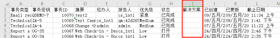

When I export the tickets as Excell CSV, the column "Solutions" are left blank(Pls refer to the attached picture). I wanna trace the ticket and check the Solutions for the ticket.
Where should I input the solution in the ticket for later check?

The solution field is usually used in Jira Software, if you want to use this field in JSD you can refer to the following instructions.
https://confluence.atlassian.com/jirakb/jira-issues-need-a-resolution-826873869.html
https://confluence.atlassian.com/cloudkb/best-practices-on-using-the-resolution-field-968660796.html
https://confluence.atlassian.com/jirakb/how-to-edit-the-resolution-of-an-issue-313467778.html

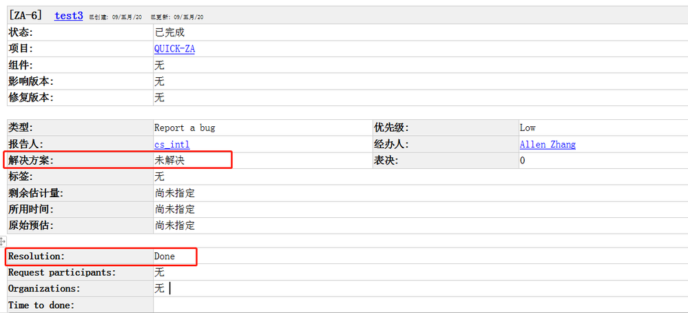

I tried to add the Resolution field on one of the Jira Service Desk project. I set the Resolution as Done but the field “解决方案” still showed "未解决". And I did not find any place to edit this column. How should I edit “解决方案”?
看上去此处的“解决方案”是一个用户的自定义字段,并非系统字段Resolution,你可以在全局字段设置里查一下是否有这个自定义字段?
当然不排除相反的情况,建议你把系统切换到英文模式,找一下字段中是否有2个相同的名字的Resolution,确认一下哪个是系统字段,哪个是自定义字段,并明确究竟要使用哪一个。
It seems that the "resolution" here is a user's custom field, not the system field. Can you check it in the global field settings?
BTW: try to switch the system to English mode, find if there are 2 fields with the same name and confirm which one you want to use.
