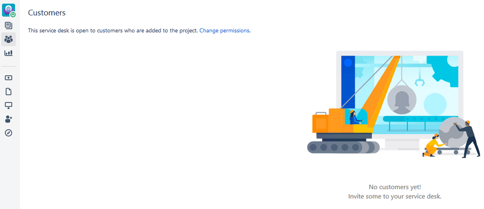

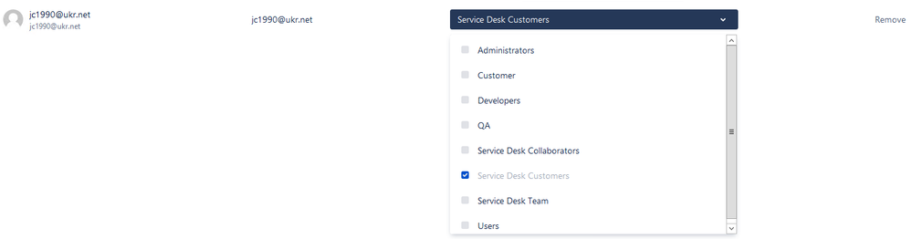

I added a Customer and set the Service Desk Customer role for him:
but the JSD says that there are no customers:
Customers.pngHere are the permissions:
When I set the Service Desk Team role I can see that customer on the list.
Why does it work like that?

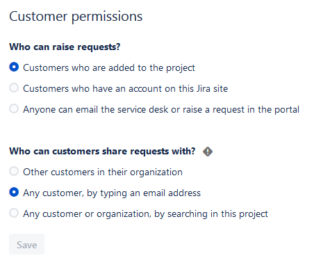

That being said, can you please check if you can directly add a customer to the list without inviting him as a licensed agent with application access? - I did not invite a customer as an agent. I added him as a customer for the JSD project by pressing the "Add customers" button in the upper right corner and providing an e-mail for the customer. But it won't show up in the Customers list unless I change the permission to "Anyone can email the service desk or raise a request in the portal" or set the "Service Desk Team" role for that user.

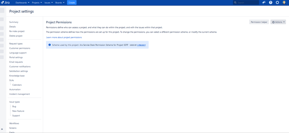

Why is the list of permissions empty?
projectpermissions.pngAlso when I press the "Permission helper" button Jira freezes and nothing happens.
