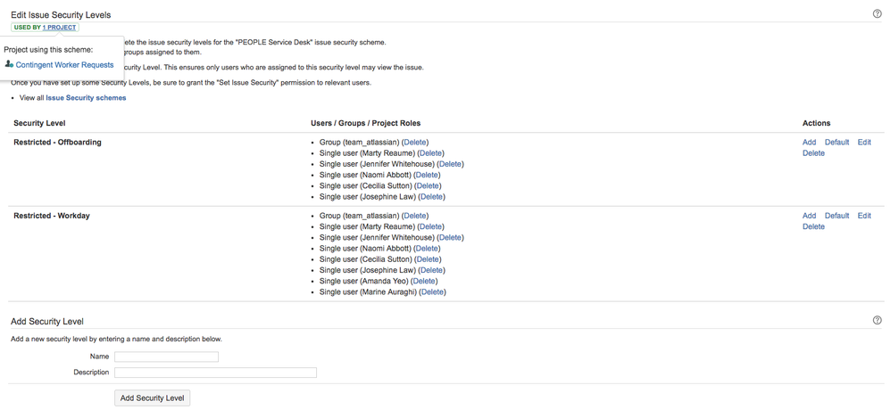

Issue Security Scheme:

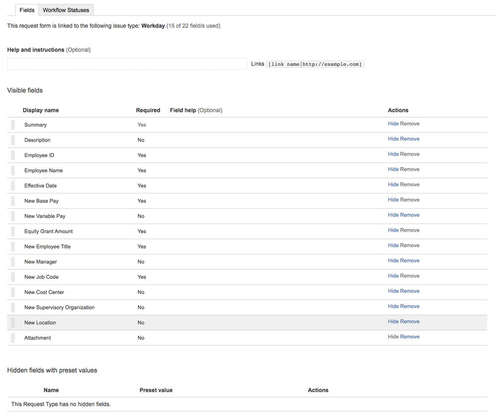

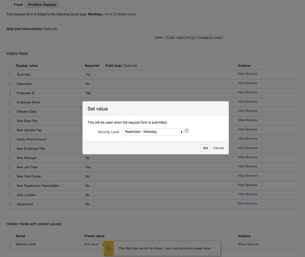

Under "Request Types" -> KEEPS DISAPPEARING!!! Have to set every day!!!
Screen Shot 2018-12-19 at 2.59.27 PM.pngScreen Shot 2018-12-19 at 2.59.39 PM.png

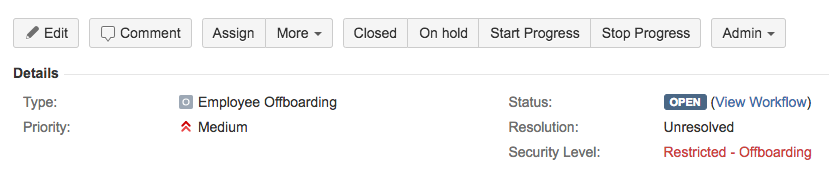

"Security Level" - When it is in please IT WORKS. When the field keeps disappearing IT DOES NOT:
Ian Johnsen
December 19, 2018
FYI - I can set Issue security
