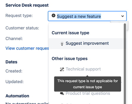

That's most likely because the request type is not applicable to the issue type that is linked to the other request type. If you turn on the old view, you can see this message when hovering to the other request type:Screenshot 2020-04-03 at 10.55.21 AM.png
The solution is to use the move operation Or if you'd like to be able to change the request type directly from the issue, the other request type would need to be associated to the same issue type.

Ah alright. The problem and the solution is the same. When a target request type is not associated with the same issue type that is associated with the current request type, you wouldn't be able to directly change it through the issue. You'd need to use the move operation. Otherwise, you can configure the request type to be associated with the same issue type
Hope that helps!
