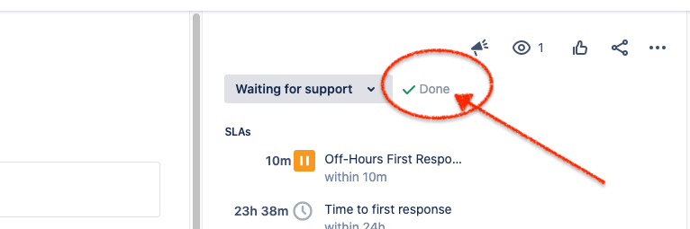

Greetings, my fellow Jira users.
Lately, tickets are created via the portal or directly in ira, are created with a "Resolution Code" 'DONE.' I am not sure if this is a bug, but it never happened before. This obviously throws off any queue that is set to find 'Unresolved' tickets.
Any insight here?

I made a quick video on what happens when I create a new issue.
The 'Resolution' field is not there until I click 'Create', and then it 'pops' into the form. How strange...
I made a quick video for you:

Nic Brough -Adaptavist-
May 13, 2021
So, you do have the resolution field on-screen.
I wouldn't worry about the "pops on screen", it will go away when you remove the resolution from the create screen - you need rid of it.
