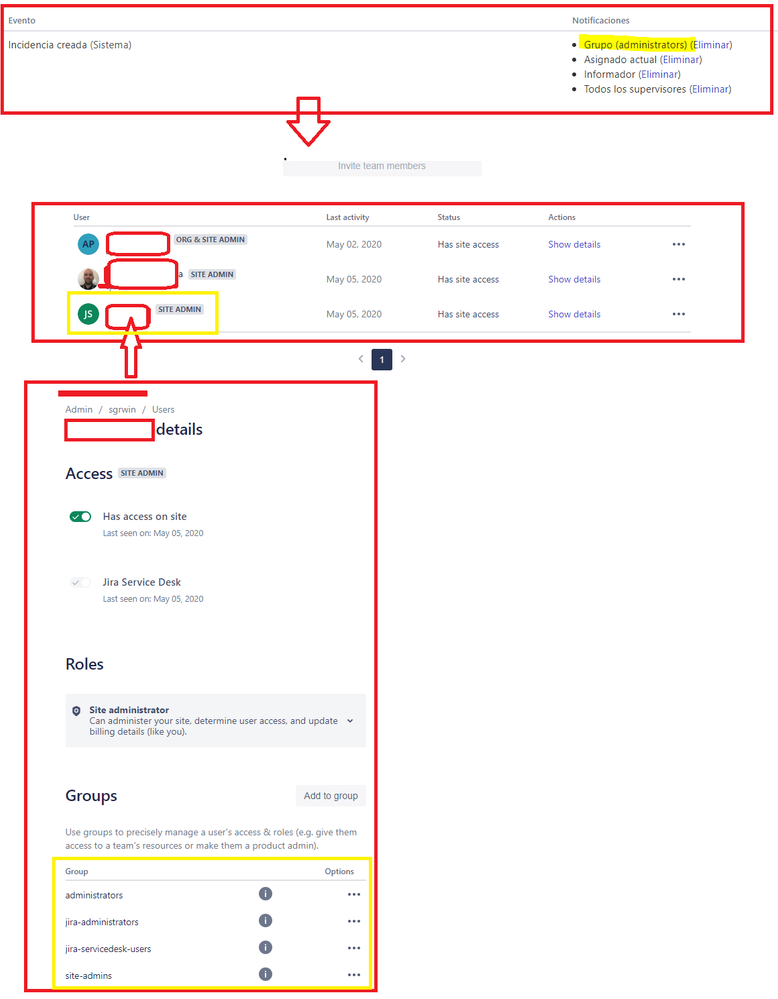

Thanks so much again Angelica. But one question more about it.
I made it and its works, then I add that notify other administrators but they dont receive the email, like the capture that Admin called JS dont receive emails, and he has activate all options you saycapture.png

Thank you for sharing the screenshot, Christian.
I checked the email notifications for JS and it seems that he received only one email notification in the last 7 days. The notification was related to an "Issue Created" event.
Then, I searched for blocks and bounces and I found some for the emails with the same domain and JS was included on the list:
550: 550 5.4.1 Recipient address rejected: Access denied [DB5EUR01FT025.eop-EUR01.prod.protection.outlook.com]
I removed this bounce and now he should receive the notification.
Please, test updating a ticket and let us know if he will receive the notification.

This morning I was going to write you, yesterday I was making some test in the notification and the user  JS is with the rol Adminitrators in the general configuration but no inside the project, then I added him to the project like Administrators too and he received the issue created mail.
Where did you found the block and bounces and where did you remove the bounce? or it only in your system?
In some hours JS will connect and we try to quit from project and send email to check the block and bounces deleted.
Best regards and thanks again ;)

You are welcome! I'm glad that it's working.
The blocks and bounces can be found by us only. We have an internal tool where we can search for a specific email address or a domain where it shows all affected emails.
