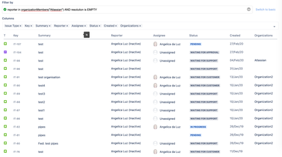

When we search for the reporter in an organization, it will show all the results from that reporter. On the example below, the organization has only one member, so you can see on the Organization's column that it will show tickets created as private and others shared with organizations:

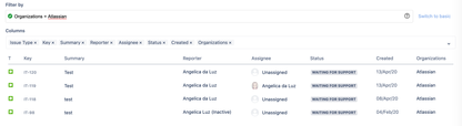

This other example shows tickets filtered by the organization and it will show only tickets that were shared with the organization:
