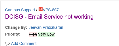

Jeevan Prabakaran
January 6, 2019
- happened more than once
- ticket was actually created by someone else
- somehow after the person creates the ticket immediately its being changed to low priority suggesting i did the change
