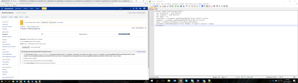

i tried by adding the script to the post function of the transition by selecting "update issue custom field", but the entire script is visisble on the view screen instead of a particular value.
please correct me if i have done anything worng.
Can you share screenshot as to where you are adding the script.
You have to add the script in the post-function of "Script Post-Function" and then "Custom script post-function"
It's pretty much wrong at many levels, you are inserting JS in the post-function which is not required, try to put the script as i have mentioned in the previous comment in the "Script post-function" and then custom script post-funciton
