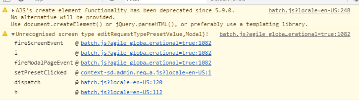

3) This is the only warning I get in the console after I press set on the assignee control

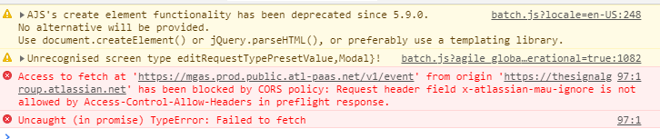

After a bit I got this error as well.
