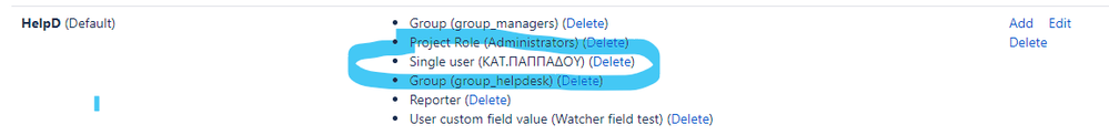

The specific security level of the scheme is the following
Marc -Devoteam-
August 31, 2023
Hi @Aggeliki K
Does the single user been granted a JSM Agent license?
Setting users relates to the same as setting a group of users, they require a license.
Or If your JSM is combined with JSW and the user has a license for JSW the user should be able to see the issues with the set issue security option
