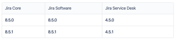

  3. Check the compatibility matrix to determine which version of Jira Service Desk goes with your updated version of Jira Software. As an example from the matrix, Jira Software 8.5.1 would require Jira Service Desk 4.5.1

It sounds like for your case, either the underlying Jira Software install wasn't upgraded, or the .obr file is for a different version of Jira Service Desk than what it needs to be to match to Jira Software. Let me know if you need more help!
