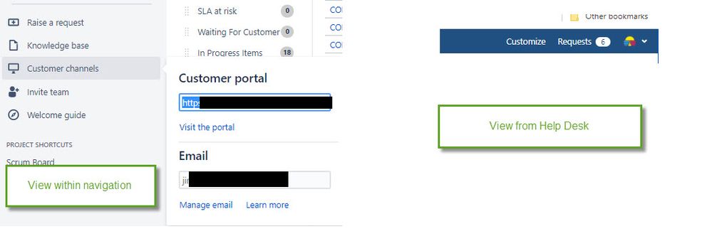

Just for us to better understand and help you with this issue, can you please let us know what do you see when you go to:
  • beside the Customer channel icon in the right-hand navigation
  • beside the Customize button in the help center view.
If possible, send us a screenshot.
On those pages, you should see the option to opt-in for the new portal.
Regards,
Angélica
Megan Makowiecka
January 3, 2020
Hi Angélica
Please find below my screenshots.
I'm not seeing any options to "opt in".
2020-01-03_12-16-45.jpgAlso noting that I'm an overall admin within our instance.

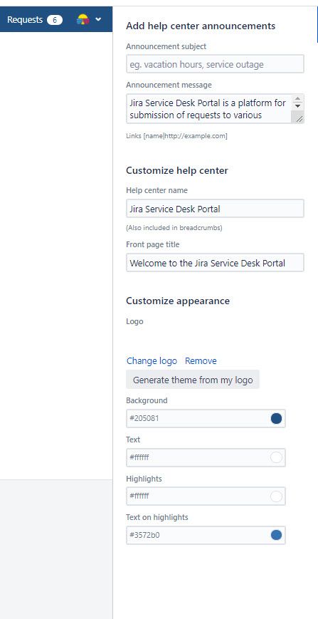

If you go to Project settings > Portal settings > View and customize, does it show any different options?
Also, you can check if the flag that disables this feature was added to the Dark Features. To fix the error, you can follow the steps below:
  1. Navigate to <JIRA URL>/secure/admin/SiteDarkFeatures!Default.jspa
  2. Enter your admin credentials when prompted
  3. Check if the flag sd.customerportal.customization is enabled. If so, remove the flag and try to enable the new looking again.
Megan Makowiecka
January 6, 2020
Here is the view I'm seeing from the portal.
I also confirmed that sd.customerportal.customization is NOT in the Dark Features.
