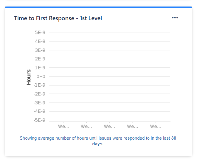

or some reason, my gadget which counts the time to first response is no longer showing results. Nothing about the filter it uses was changed, and there are tons of results from that filtered search. It's just the gadget itself that isn't showing anything where it used to.
(I have hovered over the bottom line, in case the results were under an hour, but it is not a clickable link. There truly isn't any data showing)
Gadget: gadget.png

That looks like the SLA might have been broken. You can see the full explanation on this here: Missing or corrupted SLA data in Jira Service Desk
Try running the fix on one issue first and see if that changes anything. For example:

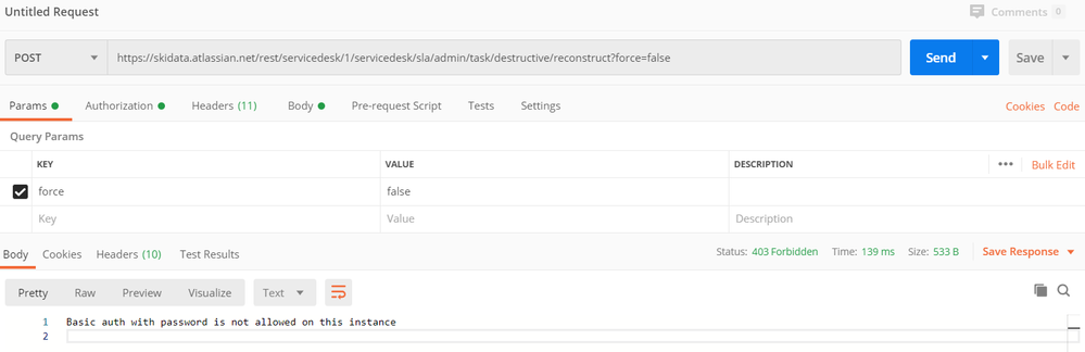

Hmm, I attempted this, and got this error:
postman results.pngAlso, even if this is successful, am I understanding this correctly in that this would have to be run on every single issue/ticket in the filter that I'm trying to have displayed in the gadget? There are TONS in there, which would take forever.

You can't use Atlassian Account password, Peter. You have to use API token. Here's how to Generate API Token.
Anyway, that was just an example that I gave so we can narrow down the problem. If that fixes for one issue, we can have it run to all. We can run for all tickets at once.
