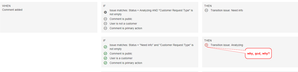

Hello,
I have been taking care of our company JIRA server instance for many months now.
I came across an unexplainable issue- I set up a simple automation rule Transition on comment.When I comment as a JIRA user, everything works perfectly, the issue transitions according to rules.
But when I comment as a customer, the rule doesn't work at all.
-Respective transitions are enabled in customer portal
-the customer account I am using is in SD customer project role
Error logs aren't that helpful, I can't see why it didnť happen.
Any help, please?

Couple of questions.
  • Has this worked before or does it work sometimes?
  • have you checked the workflow? Analyze all transitions to Analyzing for any conditions or validations that might explain the failure.

It worked and I have checked the workflow, everything is fine.
However, we have a plugin called Jira2Jira connector, which interfered with automation rules, so problem solved.
Thank you very much for your time
