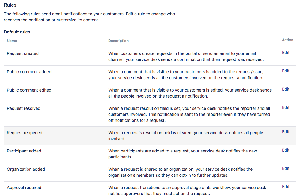

There are rules that you can edit, here are a list of the default rules on my service desk:Screen Shot 2018-12-14 at 9.01.58 AM.png
Here is some documentation about it: https://confluence.atlassian.com/servicedeskserver/managing-service-desk-notifications-939926348.html
Hope this helps!

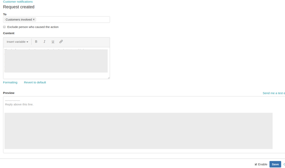

@Patrick Cartier [Candylio] and @Jack Brickey,
Thanks for the help guys. It all seems fine to me? Here's an example of the "Request Created" section. You can see that the enabled checkbox has been selected so theoretically this should go through right?
