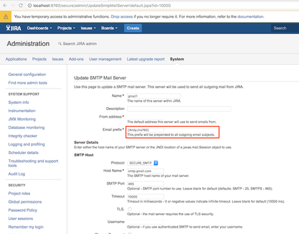

When you configuring an outgoing mail server for Jira, there is a setting you can configure in order to add a prefix to all subject lines.  By default this values is just something like:
[JIRA]
The purpose of this is so that you can more easily distinguish where this message originates from.  Say you operate 3-4 different Jira sites, it would help to set these to different prefixes to better understand where a message comes from.
I created a screenshot of one of my test systems where I configured an outgoing mail server with this.  In my case I used the prefix [AndyJira760].
You can navigate to this page if you are a Jira admin by going to the Gear Icon -> System -> Outgoing Mail.  From that page you would need to edit the existing mail server listed there to reach this page where you can change this prefix.
You could change this to use some other value like () or _ _ or just remove the punctuation altogether.  However you do need to have some value here, you cannot leave this prefix completely empty.  In which case, I would still recommend using something like just 'jira' or perhaps the hostname where this Jira resides on as a means to help identify the instance.
