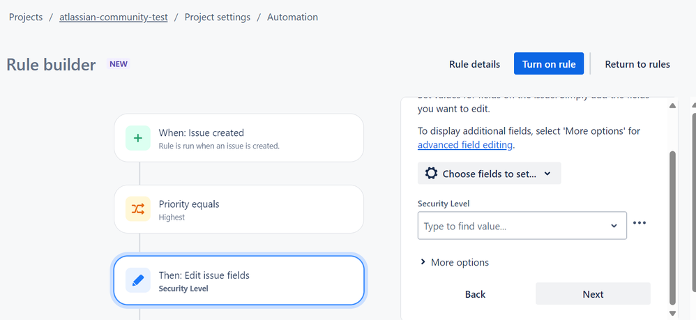

For example, you could have a rule (on any trigger) but let's say on the creation, to check for this criteria. In my example, we are checking for Highest Priority, and then have an action to set the Security Level.

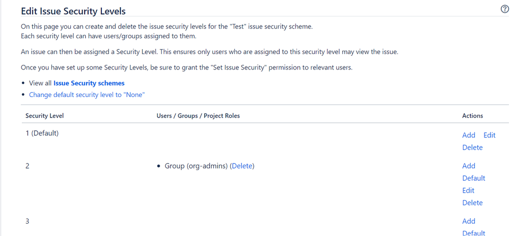

Then, in the Issue Security Scheme, you can set different levels to be viewable only to groups, or people related to the issue somehow -

You can set a level of the Issue Security Scheme as the default level that is more open, for example.
For an issue that is not confidential, or let's say has a Low Priority, you can set the Issue Security Level to one that is more permissive, allowing the Reporter, Assignee, or project role of member, or if you have a default Issue Security Level, the issue should get that level by default in the cases where the Automation doesn't insert another / higher security level.
Here is the documentation for the Issue Security Scheme which hopefully will also help: https://support.atlassian.com/jira-service-management-cloud/docs/create-security-levels-for-issues/
