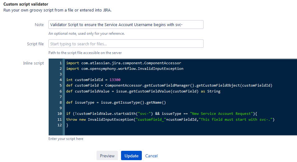

I feel like this should be a simple task, but I can't find a good simple example anywhere as everyone else seems to be doing much more complex things and I am just getting started with Scriptrunner.
All I want to do is setup a transition validator which confirms that a custom field called "Service Account Username" begins with the characters "svc-" (without quotes). The field is a single line text field. If user enters anything else in the field except a string which begins with svc- then it would throw an error.
Ideally, this validator would only kick in for a specific request type called "New Service Account Request".
Thanks in advance.

Antoine,
Thanks so much for your response. I looked up the custom field ID for my Service Account Username field and it's 13300 so the only modification I made to your code was to replace the 12700 with 13300. Are there any other modifications I needed to make?
One note:
I've created this validator on the Create Issue transition (the very start of the workflow before it hits the first status) as I assumed it would have to be caught right away.
However, it's still not working as expected. First question I have here, should I be creating this as a Simple Scripted Validator or a Custom Script Validator?
Note that I did try both, and it's not working as either...
...if I create it as a Simple Scripted Validator and try to create the request I am always given an error at the top of the screen. The error displayed is the text I have in the Error Message field on the Simple Scripted Validator setup screen.
...if I create it as a Custom Script Validator then it allows me to submit the request regardless of if the Service Account Username field begins with svc- or not.

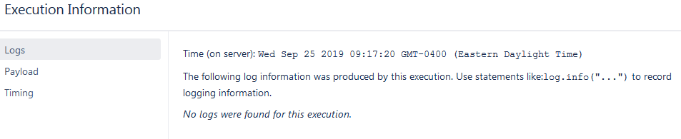

Yes absolutely, that is the only needed change, and you should use a Custom Script Validator.
I have updated the script to handle an empty custom field. Please look in the logs the value of "customFieldValue" and "issueType" so you can ensure that the if condition is met correctly.
I just tried it so and it is working properly, we will get there. :)

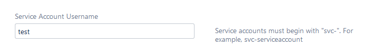

Just some other screenshots showing the Request Type, and an example where I only put "test" into the Service Account Username field but was able to submit the request. As you can see in my previous screenshot, it doesn't look like any logging is configured for the validator. Is that something I need to configure within the code? If so, would you be able to provide the logging code?
Yes, please check the above script, I updated it. :)
Oops, didn't notice the update. Okay, will copy in the new version and test it out momentarily!
Unfortunately, it's still allowing me to submit a request regardless of what I enter into the Service Account Username field. Log data provided:
I updated first answer's script, I was using the original post issuetype which was wrong.

2019-10-04 16:28:43,175 ERROR [workflow.ScriptWorkflowFunction]: Text customField value to check : test 2019-10-04 16:28:43,178 ERROR [workflow.ScriptWorkflowFunction]: issueType : Service Request with Approvals 2019-10-04 16:28:43,224 ERROR [workflow.ScriptWorkflowFunction]: ************************************************************************************* 2019-10-04 16:28:43,226 ERROR [workflow.ScriptWorkflowFunction]: Script function failed on issue: null, actionId: 1, file: <inline script> groovy.lang.MissingMethodException: No signature of method: com.atlassian.servicedesk.internal.customfields.origin.VpOrigin.positive() is applicable for argument types: () values: [] Possible solutions: notify() at Script9.run(Script9.groovy:16)
Nevermind...found the error there, the colon was outside the " " on the last log line. Moved it back inside the " " and that resolved the error. However the script is still allowing me to submit a ticket no matter what I put into the Service Account Username field...
