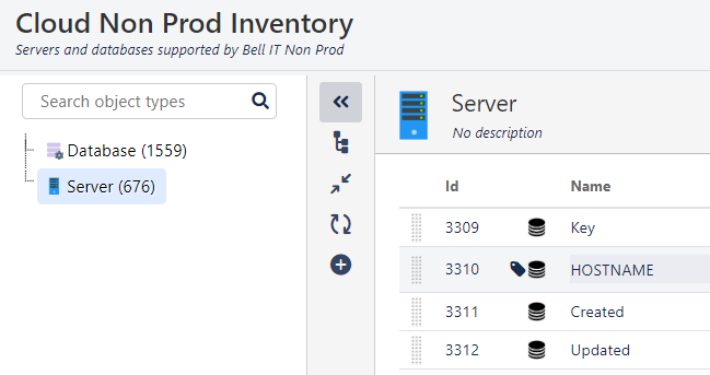

We have 2 object types in our asset schema.  Servers and databases.  Showing the server attributes here.
Then we have a custom field each called “Server(s)”  and “Database(s)  ( 48401 and 52500  respectively).
When the asset object picker gets the selected object however,  it is returning the hostname/database name concatenated with the key and we’ve tried very way we can think of to reference only the “HOSTNAME”  attribute of the selected object.
Any idea what we are missing here?  We’ve tried:

@Gurunathan Kanniappan Since Hostname is the label assigned, you can use {{issue.customfield_48401.label}}
April 11, 2024
Hi Gikku
{{issue.customfield_48401.label}} returns a null value.
