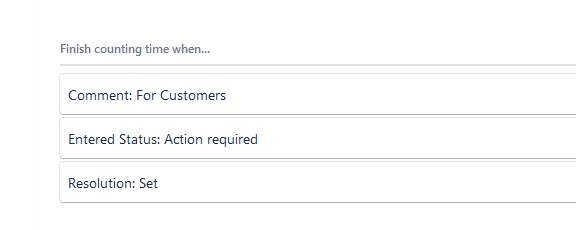

I know it might sound silly, but I'm not sure how SLA conditions working. For instance, see the sample on a picture:
In order to finish a counter, all 3 criteria should be met?
And if yes, then how I can configure a rule to finish the counter if any rule is complete?

Hi @Alexey ,
Actually no! The 3 finish conditions mean that any of those 3 will stop the timer.
Keep in mind this is a STOP condition, so if you go back to a START condition it will reset the timer and start counting from 0 again. (that is called a multi-cycle SLA).

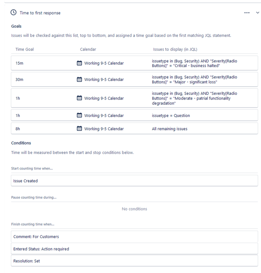

Full spec for Time for the first response:

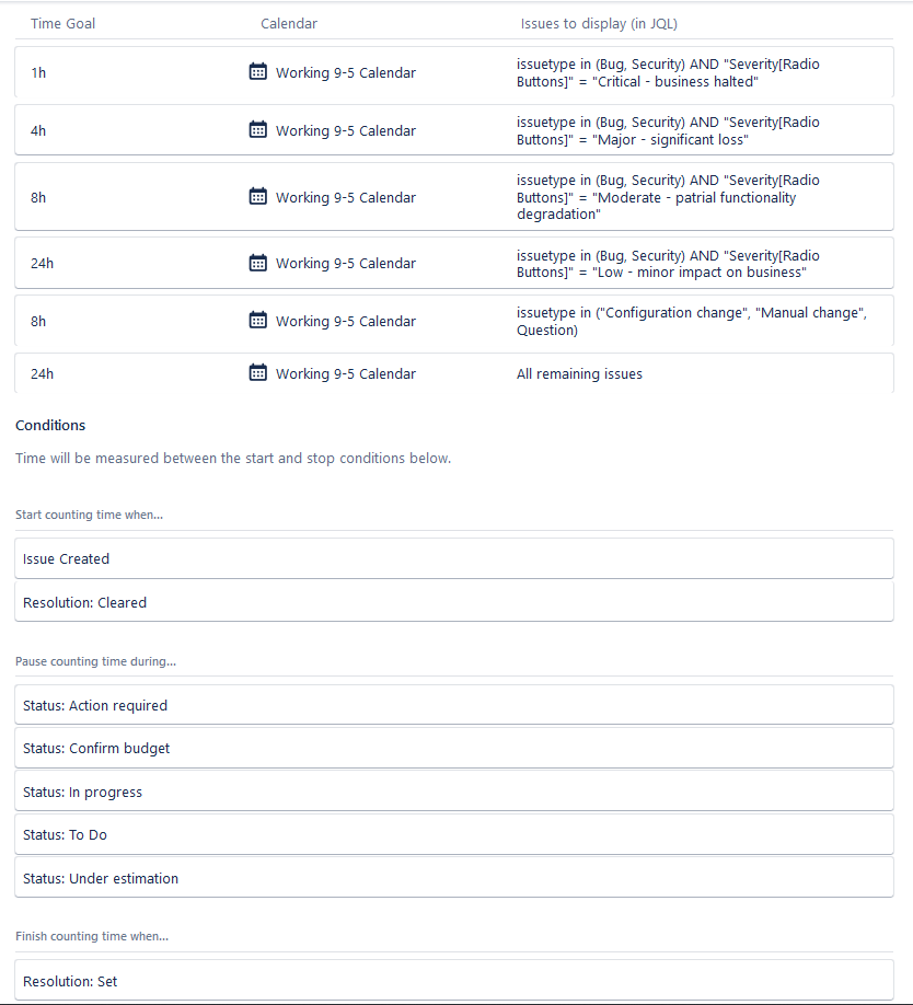

Full spec for Time to resolution:

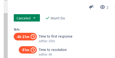

Results: Btw, it's still ticking!

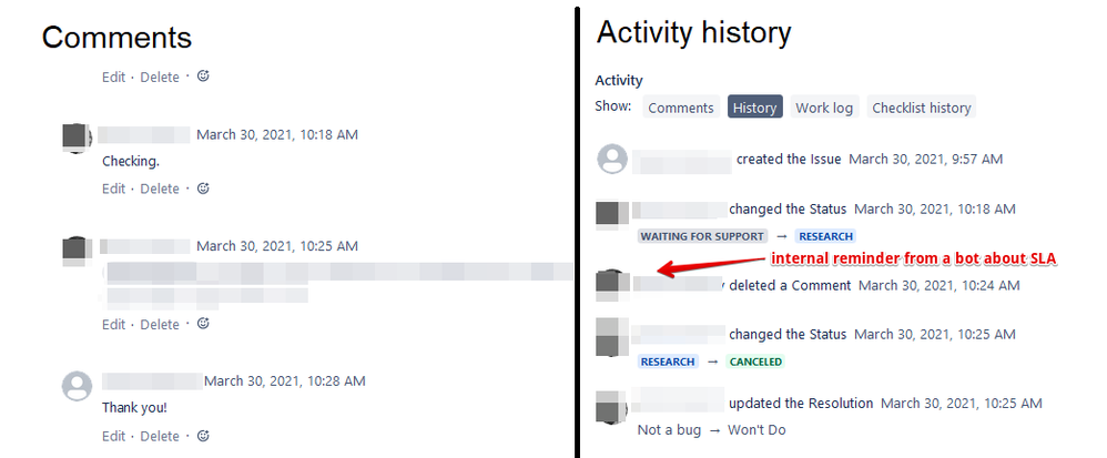

[SM-26] Two BTC accounts without _ Update Balance_.png[SM-26] Two BTC accounts without _ Update Balance_ (1).png
Clearly, the request is closed, with resolution and visible comments. Agent reacted within 20 min and whole thing was solved after 27 minutes.
It's a bug or I did something wrong?

Hey @Alexey ,
As your STOP condition is "Resolution:set" in my opinion it should have stopped.
Your START conditions don't conflict with the STOP so it should be stopped.. or at least I don't see an issue with how your SLA is set up.
As you are on a Standard cloud plan, I would escalate that one to Atlassian directly on https://support.atlassian.com/contact
Normally those Atlassian Engineers can view logs and see if maybe something is wrong with the environment itself. (it's not the first time that I've seen this..)
Would be great if they could confirm this as a bug.
I feel it has more to do with the Resolution:set than anything else. Just doesn't seem to be triggering.
As a workaround you could also add the statusses to your stop condition, Cancelled and Completed to see if it stops then.
