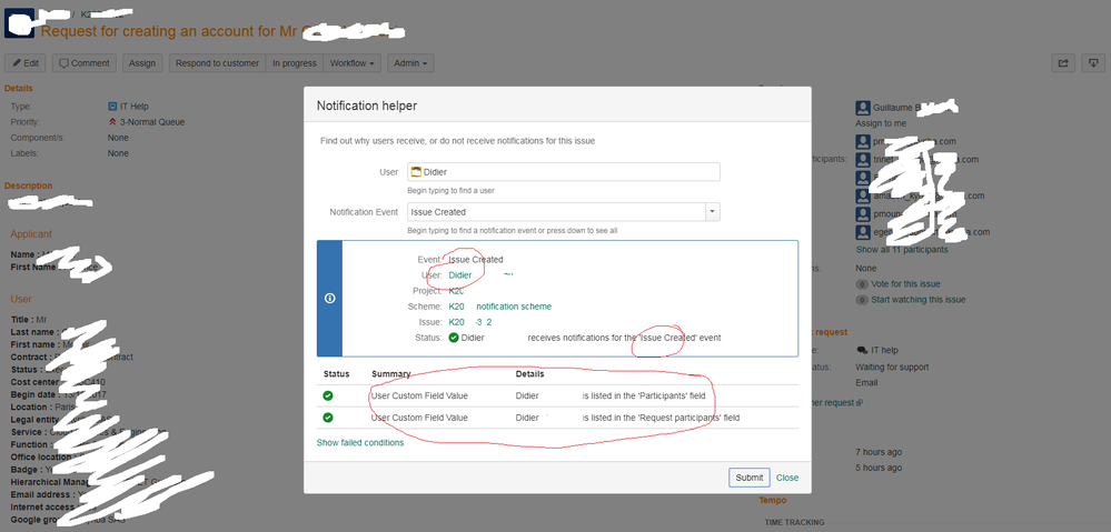

I searched since 4 hours without understanding. When I use the notification helper, all is green and the participants are supposed to receive the notification (dmartxxxx@kyriba.com for example).

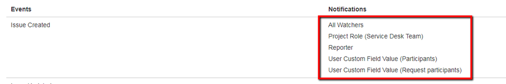

Example of requester participant who didn't receive the notification via email :
Notifications settings in the projects :

The notification helper will only verify the Jira notifications and not the Service Desk notifications.
Even though the notification scheme states that it should send the notification to the participants and request participants field, Jira will only notify users who can actually access the issue in Jira (not Service Desk customer portal), so my guess is that you are not using the Service Desk notifications here and Jira is only sending the notification to users that have access to the issue.

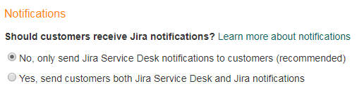

Try checking _Administration > Applications > Jira Service Desk > Configuration (or Email requests, depending on your version)_ and look for a Notification settings to make sure the SD notifications are enabled.

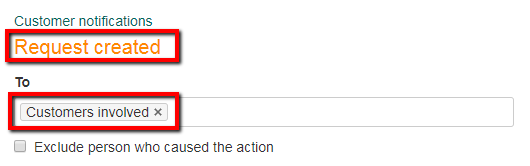

You may also want to check your "Customer Notifications" settings inside your project configuration to make sure the "Request created" rules are set to "Customer involved".

thank you for the answer. The settings are exactly how you explain.
See screenshots below :
