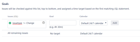

I had the logic reversed at first, but to exclude all my change tickets from displaying an SLA I added this line to the top of the table and now my queue views don't show an SLA for any Changes:

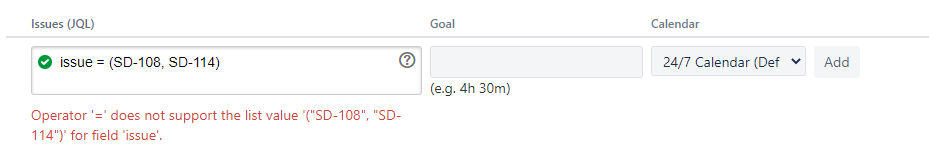

But now having a bit of trouble with the "key in" suggestion above, using that idea I want to have a running list of specific issues to exclude.  In my case I want an SLA on most Incidents in our service desk, but there will be some long-running ones that we don't want to close until they are truly resolved but all agree are waiting on a project to be solved; in the meantime I don't want those issues plastering red all over my queue views.
I'm getting close but this isn't quite working yet.  Any advice @Callum Carlile _Automation Consultants_ ?

JQL typo:
Issue IN (SD...)
