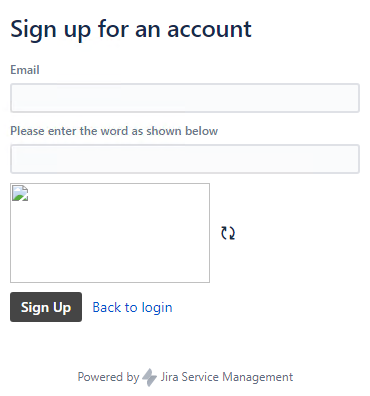

Recently upgraded to JIRA 8.15.0 and whenever public users attempt to create an account, when they click on 'Sign Up', nothing happens and the CAPTCHA resets. Literally, if I test it myself, I can keep clicking on "Sign Up" and the CAPTCHA just refreshes over and over. No errors come up. Does not make a difference if a legitimate email address is filled in along with the correct CAPTCHA code (for example, if I put "test-account@gmail.com" and "arcting" as the CAPTCHA, nothing happens when I click on "Sign Up").

Does anyone have any idea what is going on? Again, I can just keep pressing on "Sign Up" and the site does nothing. It just refreshes the CAPTCHA and that's it. The button should be called "Refresh CAPTCHA and do nothing". It is extremely annoying because no public users can make an account and raise tickets/service desk issues! It's causing a bit of frustration.
Public access is ENABLED. Even if I disable CAPTCHA, it still won't do anything and I can keep clicking on "Sign Up". This was working all fine until I upgraded to 8.15.0. And yes, I have tried using my browser (Google Chrome V88.0.4324.190, Windows 7 32-bit) with a cleared cache and all cookies removed. I have also tried using Mozilla Firefox. Same problem persists.

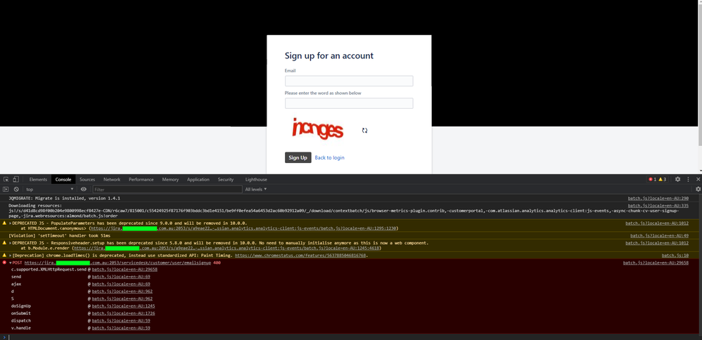

As a hail marry could you open the developer console and see what comes up when you do click the button?
They wanted my SEN number, but I didn't provide it because I've been using JIRA since 2016 and support expired long ago for me. So they didn't bother assisting me further.
Sure, I actually tried that and I was getting a 400 error back (as seen in the logs above).

400 is a "bad request" so that's gonna be a tricky one.

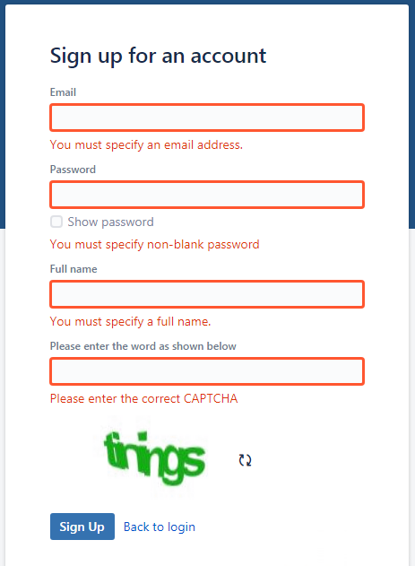

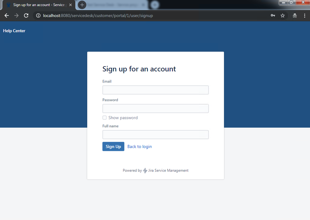

Small update. I installed Jira from scratch on a Virtual Machine and it's completely different from my production system. What the hell is going on?! I might copy all the core files from the new install over my existing production installation because I now have a feeling the core files did not automatically update correctly and the Atlassian installer is completely broken.
Of course, enabling CAPTCHA results in it appearing too, and when I click on "Sign Up", it responds correctly (unlike mine which is completely f**ked up).

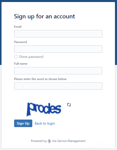

Okay, I reinstalled everything from scratch and added my existing database. Same problem persists from my first post. I am getting a CAPTCHA image now, but when clicking on "Sign Up" it does shit all.
