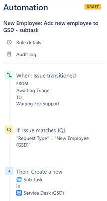

I can't get triggers to work properly to create sub-tasks
This doesn't work

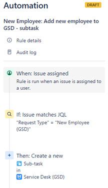

Nor this

But this does as a work around. Of course if the request is re-assigned then the sub-tasks are duplicated.

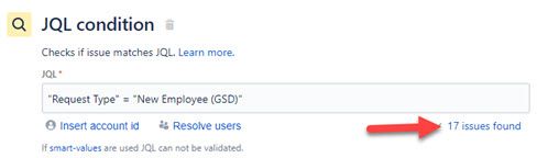

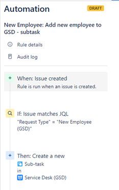

"Issue created" and "Issue migration" triggers miss the requests and I can't figure out how to fix it. The JQL Condition can see the requests but the triggers skip over it
What am I doing wrong?????

Hello @Chad Cooper
Thanks for writing to us.
I checked for Issue created one. Seems like you are doing fine. I suspect that condition didn't meet when you created a new ticket of a particular "Request Type" you are interested in and hence subtask was not created. I would request you to share the audit log (see link to know where you can find audit logs) after running the rule, to know what exactly is missing.
Also may I suggest to bit simplify it and get rid of the JQL condition.
Something like:
Trigger: Issue created
Condition: Issue Fields Condition (just from dropdown select Request type as "Field" and value again from dropdown).
Action: Create subtask
Waiting for more details.
