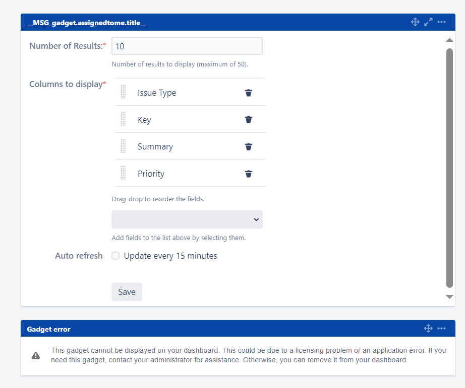

However, my user A can access dashboards when shared with him, but gadgets names are bugged and some gadgets don't even work and/or filters are buggued
I attached a screen to show you that.
If this user A connects from the base url https://myjira.com, problem dissapears. In both cases, he uses the same account, with same rights, filters and dashboards are properly shared with him.
I added the https://otherurl.com/* wildcard to the allowlist, but it changed nothing
I seen some 404 not found in the console when requesting from the otherurl.com, on a https://otherurl.com/plugins/servlet/gadgets/error/spec-not-found
When I try to add a gadget, from https://myjira.com I got 24 gadgets and no problem. From otherurl.com I only got 21 (and not the filter result gadget, which is the one in Gadget error on the upper picture

Hi @Va man
I haven't configured Jira on-prem for a long time.
But look at this KB article; fix-gadget-titles-showing-as-__msg_gadget-in-jira-server
I hope this will help you out.
