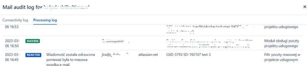

In processing log from your point 1 is something like that:

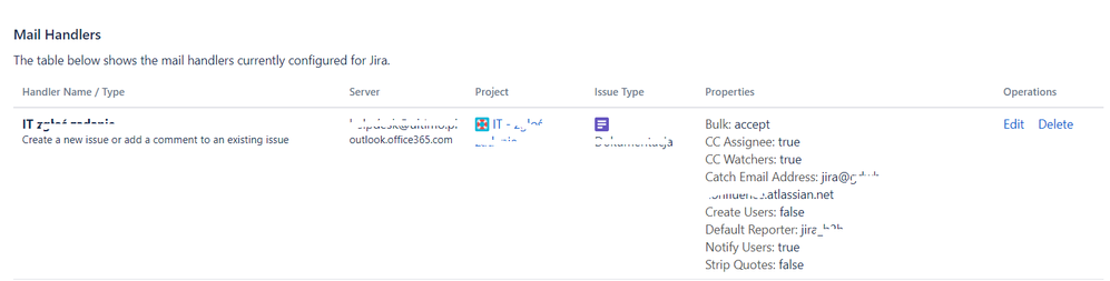

Which meen, that email was rejectet as bulk. I've tried to add own mailhandler, but it doesn't work:
I've also tried to whitelist domain in different version, as is in allowlist, and it also failed.
