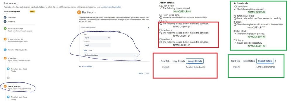

Hi all,
I created a very simple priority assignment rule based on impact field. This part worked for a few days but then stopped. Please see attached screenshot for explanation. The incident submitted two days ago by same person/same form/same fields worked (highlighted in green above), however, since yesterday the match is no longer found (highlighted in red).
Anyone had any idea why it stops working? Note that I had another more complex rule initially implemented which worked for a few days and then stopped for no reason. I thought that logic was too complex so I created a plain rule which worked for a few days and then stopped as well. Any ideas what's goin on? This is a simple 1 input field and I had no changes to anything. I also set 5 seconds delay to re-fetch the data just in case.
Totally at loss what's going on and what am I missing.

Hi @Alex and welcome to the Community!
Is there any reason why you have a Refetch issue data action in your rule? You might have of course, but just looking at your rule I can't really figure out why you would need that here. This may impact the data that's on your issue, so I would suggest to remove this and see what happens.

Alex
October 28, 2024
Just received a few new incidents. Still doesn't work even with data re-fetch deactivated.
Not sure what's going on. I had two rules and both of them worked for a few days and then, suddenly, stopped, the rules are based on a single field.
I guess the field passed via the form is not the same as used by automation? The name is the same though but for some reason it doesn't accept the value passed in it.

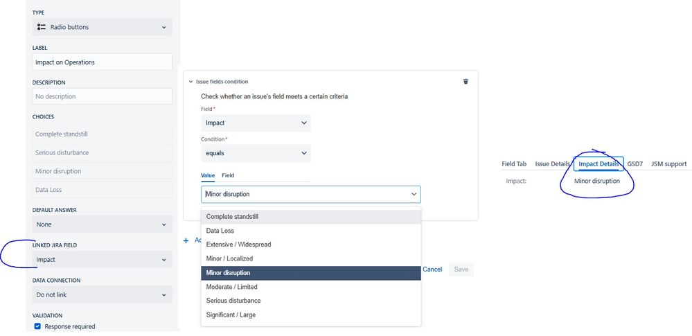

Alex
October 28, 2024
Yes, I'm mapping the form field to Jira field. The field seem to be the same as I don't see any other options with the same name. See attached.
Could you please elaborate on the context for different projects? I do see this field set up in Fields section but I can't dive deeper into that part as I have no access, that seem to be managed by our corporate jira administrator.
