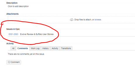

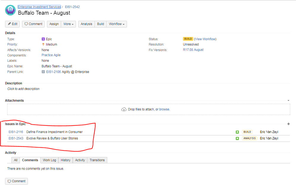

1) This is my issue type – EPIC and I have 2 issues in EPIC EIS1-2116 and EIS1-2543

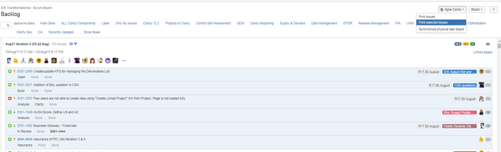

2) Select cards to print and then select printed issues

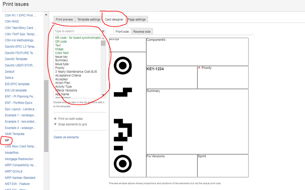

3) I created customise print template "HP" and selecting fields which I want to see on the card. But I cannot see field "issues in EPIC" and hence my 2 issues in EPIC EIS1-2116 and EIS1-2543 does not get printed on the card.

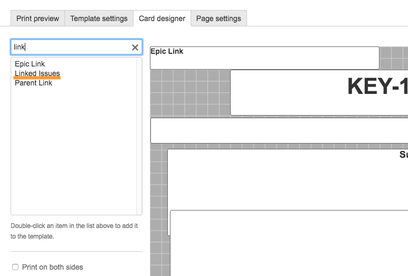

I tried field "linked issues" but that is not working either.

@Hetal For your assurance, we're planning to refine how issue data from 'parent' issues is configurable within card designs early next year.
This is on the backing of user requests for the same application between stories and tasks, or tasks and subtasks.
Our current version of Agile Cards has linked issues, rather than those which are added via the 'Epic Link' option.
