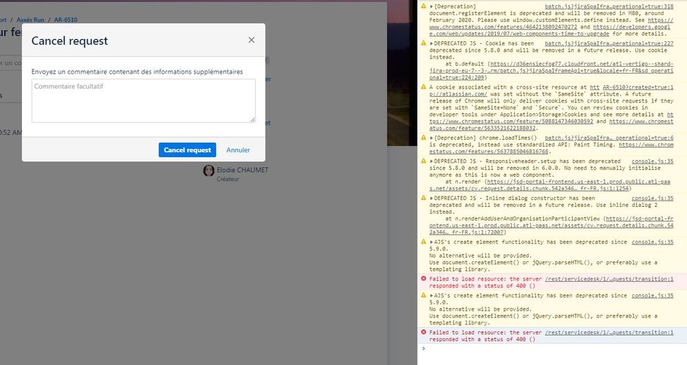

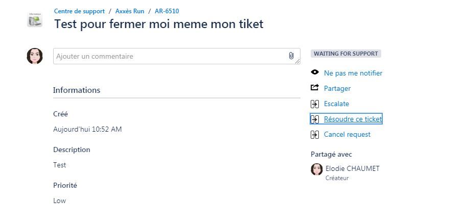

In our portal, the buttons linked to workflow (Cancel request, solve ticket ...) are present but doesn't work.
An error 400 is raised when submit the request and nothing appear.
console.js:35
/rest/servicedesk/1/customer/requests/transition:1 Failed to load resource: the server responded with a status of 400 ()
I restored default workflow but the problem still the same.
Do anybody has facing this issue and solve it?Jira issue.JPGjira issue 2.JPG

Elodie CHAUMET
October 21, 2019
@Manon Soubies-Camy  here it is :
{"errors":[{"errorMessage":"Impossible de récupérer la configuration du champ","field":"customfield_10060"},{"errorMessage":"Impossible de récupérer la configuration du champ","field":"customfield_10058"}],"reasonKey":"transition failed validation","reasonCode":"400"}
Fields 10058 & 10060 are Creator & Creator Email. The description of the fields include the following comment : "created by JIM during import process"
It seems something is wrong with these fields, because on the field interface (JIRA admin> ticket menu), when I want to edit the field , I also got the "Impossible de récupérer la configuration du champ". Screenshot attached.

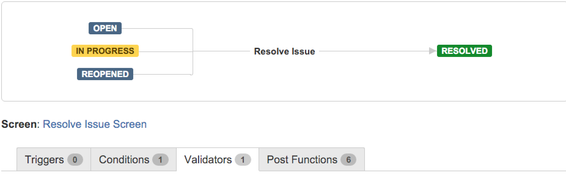

Do you have administrative rights in Jira? If so:
  1. Go to these URLs to find out which fields are mentioned in the error message: https://<yourJiraName>.atlassian.net/secure/admin/ConfigureCustomField!default.jspa?customFieldId=10060 and https://<yourJiraName>.atlassian.net/secure/admin/ConfigureCustomField!default.jspa?customFieldId=10058
  2. Go to the workflow and check if there is any Validator associated with the transitions shown on portal:
Hope this helps,
- Manon
Elodie CHAUMET
October 21, 2019
Hi manon.
:-( no validator on the workflow. Could it be linked to publish functions?
Manon Soubies-Camy
October 21, 2019
Can you please share a screenshot of both the Validators and the Post-functions (Fonctions de publication in French) tabs for the "Cancel request" transition?
