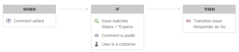

I see however a need to setup triggers to transition on comment when the customer make the comment, sometimes your customers may think that just by commenting they are resplying the agent (not every comment is a reply that represents a intent for the agent to take over the request), some customers depending on your model may not even know how to use properly the customer portal, so in this case I see a advantage.
What can be done in those cases is setup an autommation rule like this.
Trigger (WHEN): Comment added
Condition (IF): Comment is public and User is a customer
Action (THEN): Transition to waiting support (there is a transition that can be triggered).
Like in this screenshot below.
chrome_2017-07-05_20-29-38.pngYou can do the other way arround, so when a agent comment you transition to waiting customer, but as I said it may not be the agent intention every time.
Then once that you can change status using comments as triggers you can use the status as keys to manage when to start/pause/resume your SLAs.
