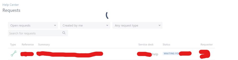

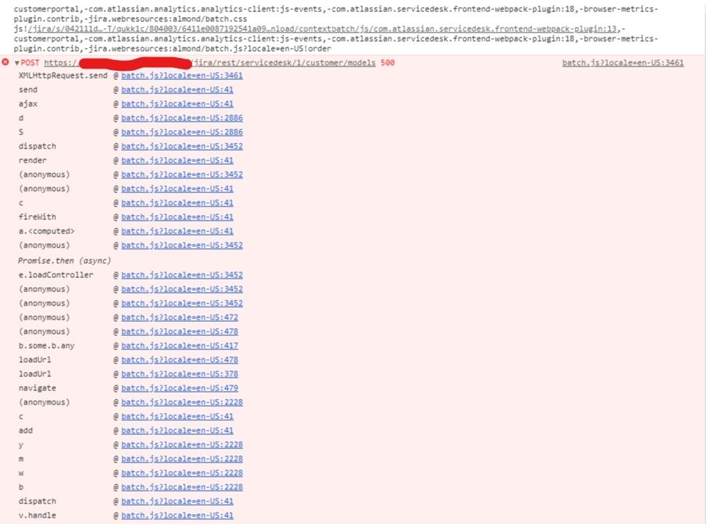

I manage jira service desk but lately some of the users have started receiving POST - https://<BASE_URL>/rest/servicedesk/1/customer/models return 500 error while accessing some of the cases from the end user service desk portal. It is not happening with everybody and not on all opened requests and thus I am unsure about the root cause and what to look for. End users get rotating wheel of loading in all browsers such as Chrome, FireFox and Edge and in console window error 500 appears.
Any help would be really appreciated
I have attached 2 screenshots of the error and hope to get some help on this issue. jira-error.jpgjira-sd-error.jpg

Thank you for the reply but I did check this link before and this is not similar to the error I am getting. In the article, it is mentioned that "When customer navigates to Requests page in customer portal and tries to filter tickets by status a HTTP 500 error is thrown :"  but it is not the case rather, this error occurs when only a particular user click on a particular case opened by him/her.
