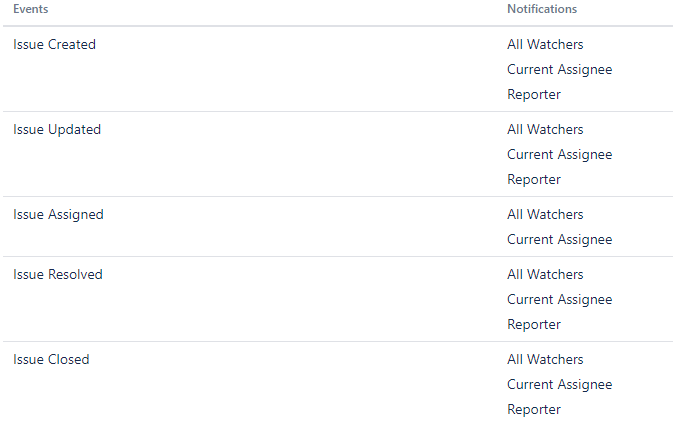

The assignee of an issue in our Jira Service Desk (4.5.1) Server is not getting notified, when a customer closes the ticket with the transition buttons we made visible on the customer portal.
The notification settings seem to indicate that the assignee should get the notification:
I have looked at this article. https://confluence.atlassian.com/jirakb/service-desk-notifications-not-sent-on-resolved-or-reopened-requests-800293284.html but I am not sure it applies. Within the workflow, we set the resolution by transition properties (servicedesk.customer.transition.resolution).
Do you have any ideas why this is not working? Thanks a lot!

Does server have a "notification helper"? Cloud allows you to check what should happen for a given user and issue and event. Did you check the workflow to ensure that the Generic Event is in the Post Function for the transition to closed? I would be surprised if it was missing but something to check.
Stefan Stark
December 10, 2019
Yes, I should have mentioned that: the notification helper says the assignee should receive both issue resolved and issue closed (as long as the change was not done by himself, which is wasn't). And yes, the Generic Event is part of the post function, though I have to admit I don't quite understand how this is connected. What does the generic event do in this case?
